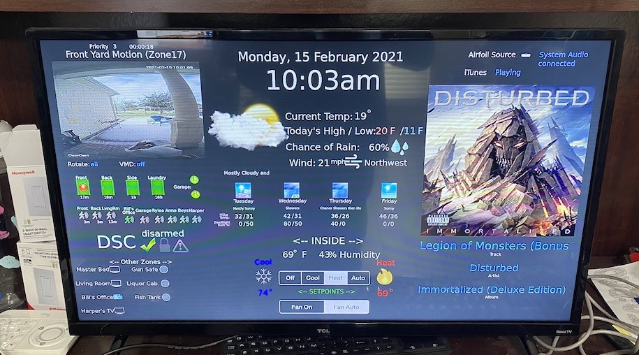

My current rPi deployment is raspian light that boots directly into a no curser chromium which loads directly into an indigo control page. Simultaneously, sharpoint-sync (airplay) is loaded. This is attached to HDMI 1 on 4 TVs throughout the house.

This is Experiment 2, currently displaying an indigo control page, streaming audio from iTunes on indigo machine and piBeacon is running in the background, but not beaconing:

One of the reasons I posted a picture of the control page... I was hoping someone else that uses your plugin (and knows linux/ rPi) would think that is a good idea and take it on also.
