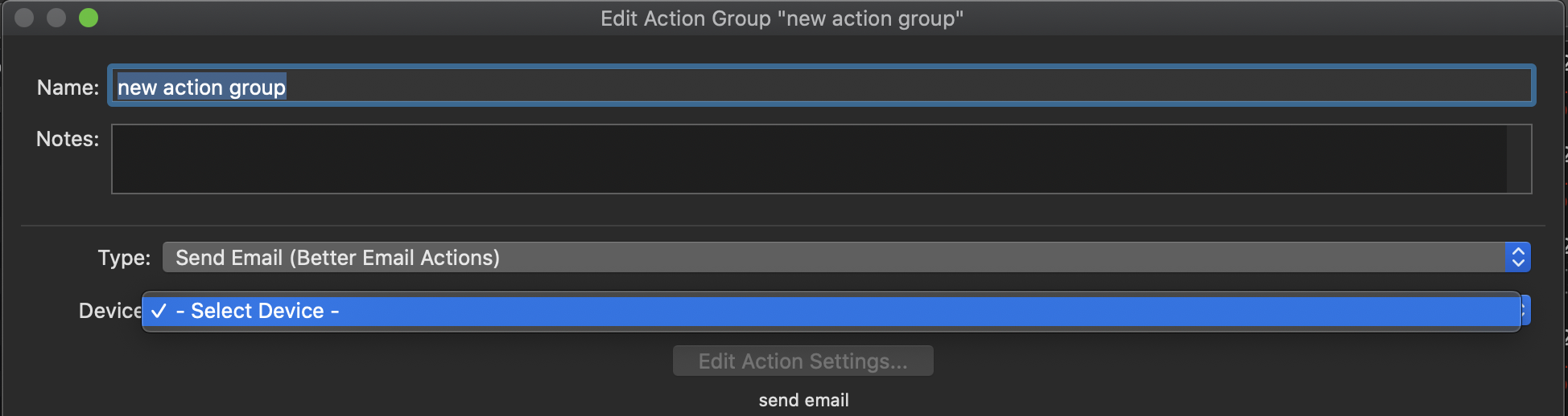

Better email is reading my inbox no problem, but I just noted I cannot select the Better Email DEvice in the drop-down for the Beter Email "Send Email" Action Group:
Screen Shot 2021-01-26 at 11.34.28 PM.png (197.25 KiB) Viewed 2085 times
Thoughts?

Have you created the device you need? For sending email, you need to create an SMTP device. Which is not the IMAP or POP device you created for reading the emails.

Wow- apparently when I was last sending emails it was via the built-in email function.
I added an smtp server Indigo Device (a gmail account) and it worked immediately. Thanks so much Joe!
