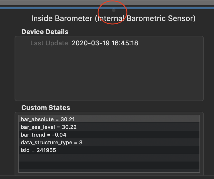

Re: NOAA Weather Plus discussions
What are the actual states of the device when you get the error? You can show them in the Indigo UI by dragging the dimple up.
Screen Shot 2020-05-10 at 10.17.46 AM.png (80.22 KiB) Viewed 5280 times
