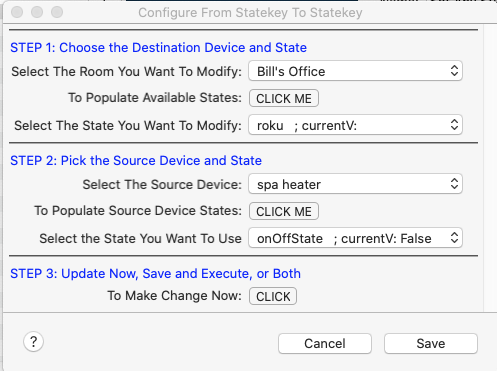

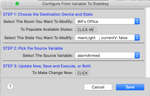

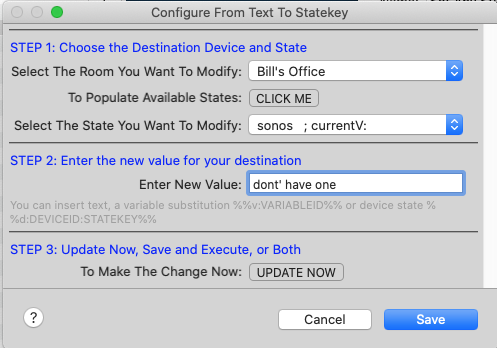

For the remainder of the states, there are three options: Update by text, update by state, update by variable. With all three, the dialog prompts you to select the room from a dropdown of all your rooms. Then select the state from a dropdown that shows all your states and their current value, then...
With update by text, you can enter any word, a %%d:device:statekey%% or %%v:VariableID%% and those will all be accepted.
With update by state, you select a device from a dropdown box with all your indigo devices, then a drop down to select the state for that device you want.
With update by variable, you select a variable from a dropdown off all your indigo variables.
On the bottom of the dialog there is an "UPDATE NOW" button. So if you are filling in multiple fields in a new room, you can click that then change the room.state and so on until your done... or you can save and execute like any other action.
