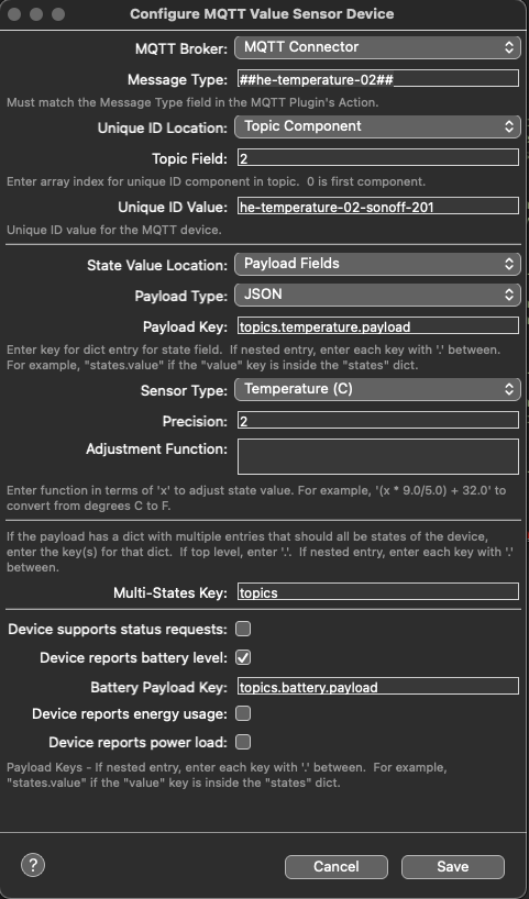

I have tried this:
Screenshot 2021-01-10 at 18.36.11.png (107.94 KiB) Viewed 2072 times
but I am getting an error:

Re: Multiple topics mapped to same Indigo Shim device?
You won't be able to use multi-states because of the way the payloads are nested. But you should be able to define a temp shim and a humidity shim, both showing battery status.
I had to do it that way because of varying topic lengths for the same topic base.

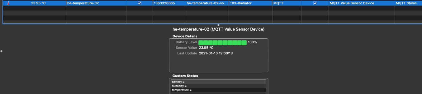

I removed topics from Multi-States Key and am now getting this:
Screenshot 2021-01-10 at 19.00.53.png (39.8 KiB) Viewed 2068 times
The custom states are listed but empty.
The battery status is being shown as 100% OK.
Is this what you would expect?
It will work for me in its current state. :D
Yeah, it created those states before you changed the setup, but it wasn't able to populate them. If you created this device from scratch without the multi-states field, they wouldn't be there.

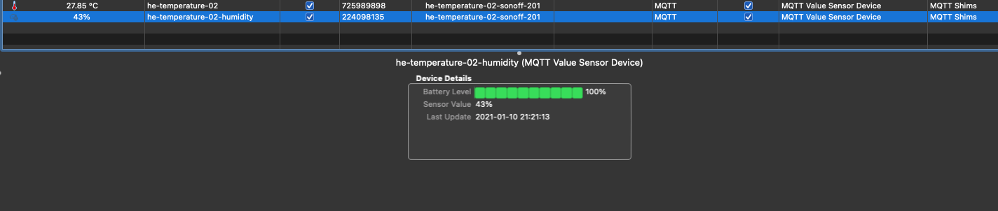

As you suggested, I deleted and recreated the devices and now it is working perfectly.
The aggregator is a useful and nice feature! :)
Screenshot 2021-01-10 at 21.21.27.png (41.8 KiB) Viewed 1990 times
No custom states now listed and both Indigo devices running off the same source device, a Sonoff temperature sensor. :D
