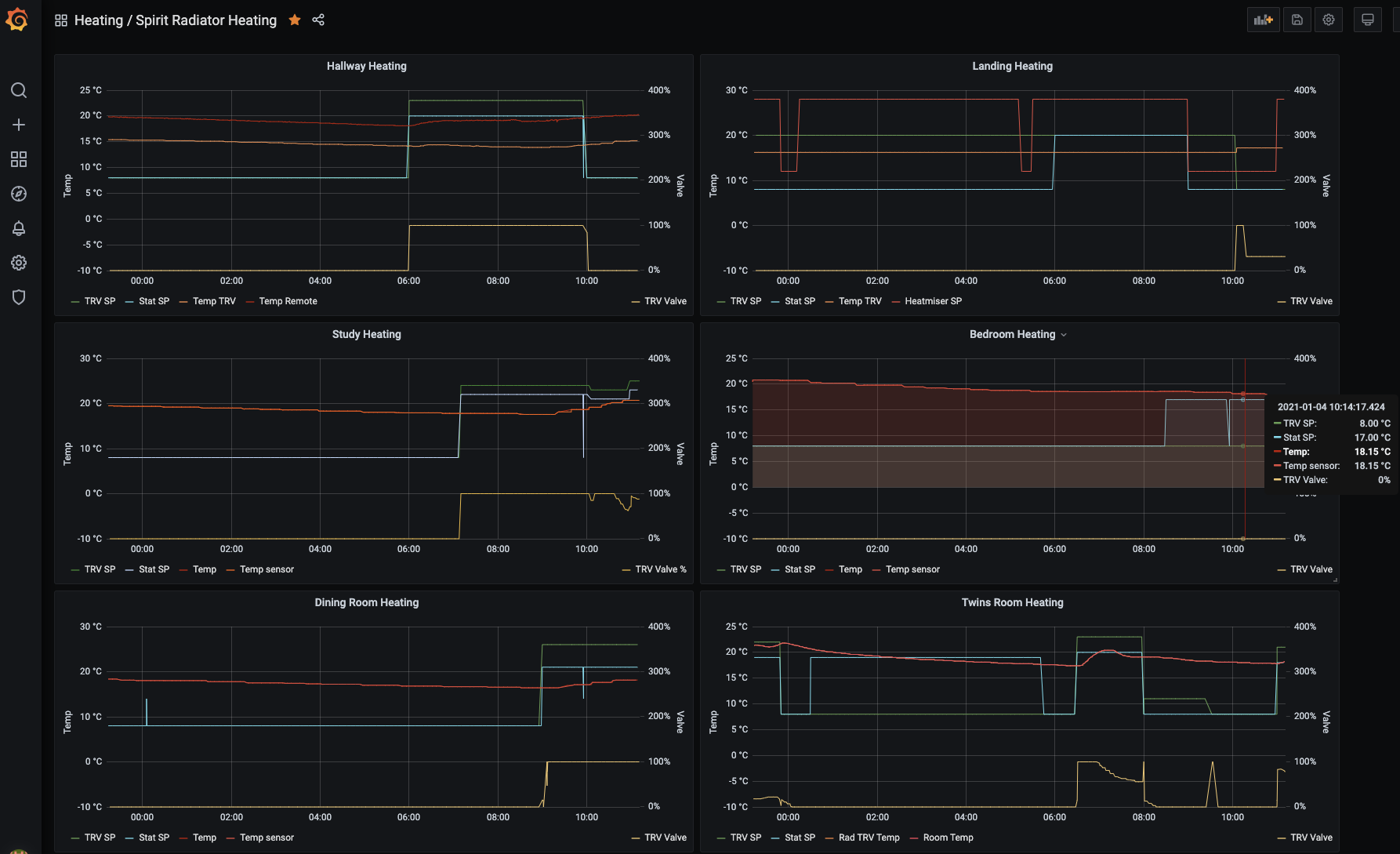

Thought I would share here a shot of the grafana dashboard I use to monitor my Spirit TRV's. (I also have 12 Heatmiser thermostats and have similar for that)
This one is setup per device manually, but its possible to create one generic panel and then apply to many Spirit TRVs and plugin devices.

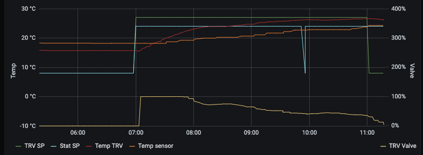

And on this one in detail, using a remote temp sensor, it shows how the TRV device is set as higher set point of 3 degrees. As the temp sensor approaches the TRV device it slowly reduces the TRV valve to avoid overshoot. By making a higher override, say 5 degrees, the valve would stay at 100% so heat faster, but with more risk of overshoot.
