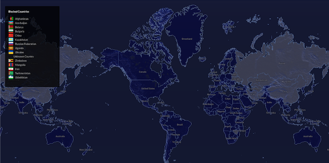

You can stop lot of probing on your router: the Unifi controllers have this nice feature:
Screen Shot 2020-12-30 at 20.07.50.png (234.46 KiB) Viewed 2198 times
You can block any ip from certain countries (up to 15 countries): under routing&firewall / geo ip filtering one country after the other, or in thread management click on the countries in the map
-- besides blocking individual IP#s or ranges in routing-firewall/firewall/rules and groups
and thanks to Matt for pointing me into the right direction.

I've been getting more of these port probe messages of late, too (as recent as yesterday). I've checked, and I got a series of messages (from the same IP) at almost the same time as Karl leading me to believe that the offender is sniffing the reflector and not me personally.
On the UniFi front, I can't do the geo-filtering as it requires the hardware offloading that's disabled by Threat Management (not sure why, but it's an either-or). I'm a bit disappointed that there's not an easy way to blacklist a single IP in the firewall. Blocking a whole country seems a bit like swatting a fly with a shotgun, and it seems like a blacklist wouldn't require too much from a resources perspective.
