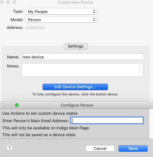

Step 1: Configure the "Person" Device:

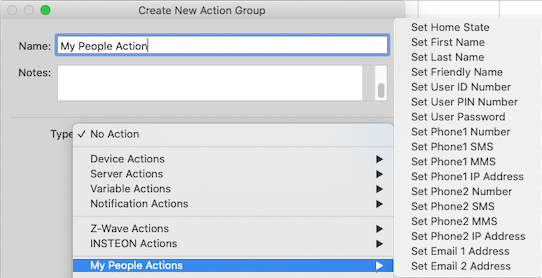

Step 2: Use Actions to populate device states:

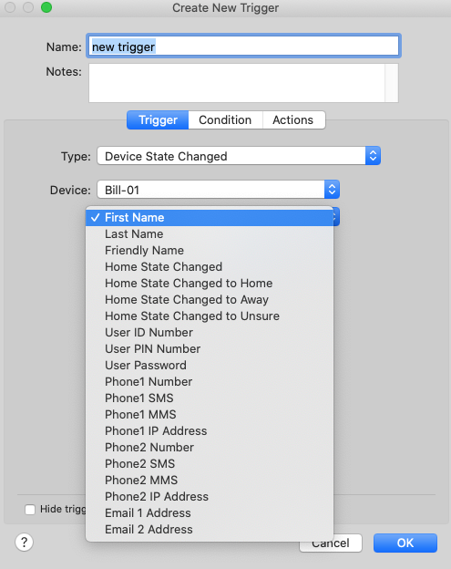

Step 3: Use Triggers with this plugin to fire off other stuff:

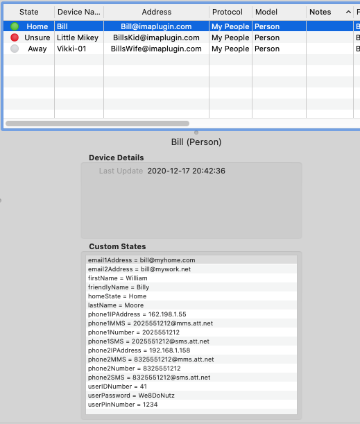

Step 4: Note the custom device states from the main UI:
