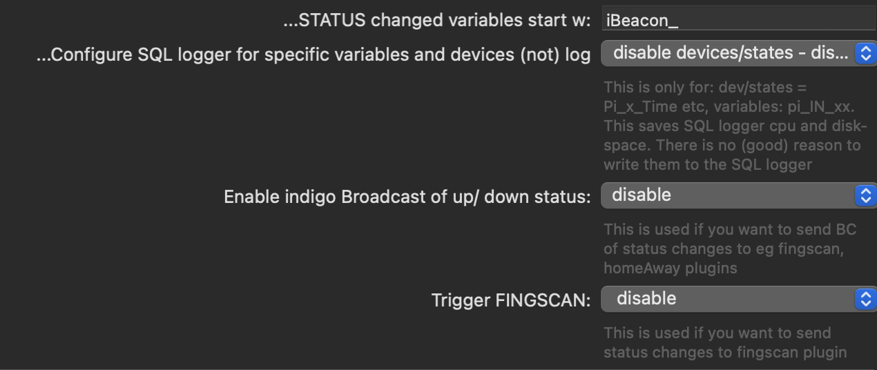

Hey Karl...I just reinstalled piBeacon in my system using a pair of Raspberry Pi Zero W units that I wanted to attach a few sensors to.
I'm not using the iBeacon parts at the moment but might if I can find the moving box I tossed the beacons I have in.
My logs are blowing up with SQL Logger and beacon stuff, and it's definitely increased the CPU load on my Indigo i3 Mac mini.
Here's what I see flooding the log:

I thought I had turned off the SQL Logger stuff for it, as in screenshot attached.
What am I doing wrong?

That indigo
When a device state gets created as number =integer ( only option) and the data is a real number indigo / sql changes the property to real when it gets populated
Normally when a device gets created it happens one after the other. But if all
Of them get created at once sql might get overwhelmed.
Don’t stop sql but stop pibeacon wait 1 minute then restart pibeacon. Do this several times until all states have been converted.
Sorry I can’t do anything about that until indigo offers real number for a state at initialization.

I managed to stop the traffic (for now) by changing to this setting in Accept/Reject New Beacons
RSSI >-5; Tag=off
When I re-introduce beacons I'll adapt and get it working
