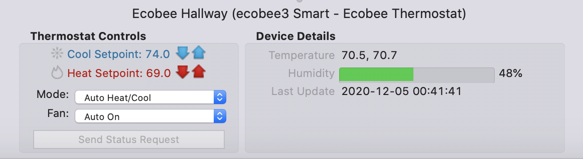

I have an Ecobee 3 thermostat with 5 remote sensors and I want to calculate the average temperature and write the result to an Indigo variable. The problem I am running in to is that the plugin reports two (2) values for the thermostat sensor (Zone 1 & Zone 2). The device data being pulled in to the script for the thermostat sensor looks like "70.5, 70.7", this is causing the script to error because it is not a valid number. Below is the Python script, note that Temp1 is the thermostat sensor and that I have excluded it from the list for "Temps" definition. The script works properly when excluding "Temp1", but fails when it is included.
Screen Shot 2020-12-05 at 00.56.36.png (148.81 KiB) Viewed 2663 times
