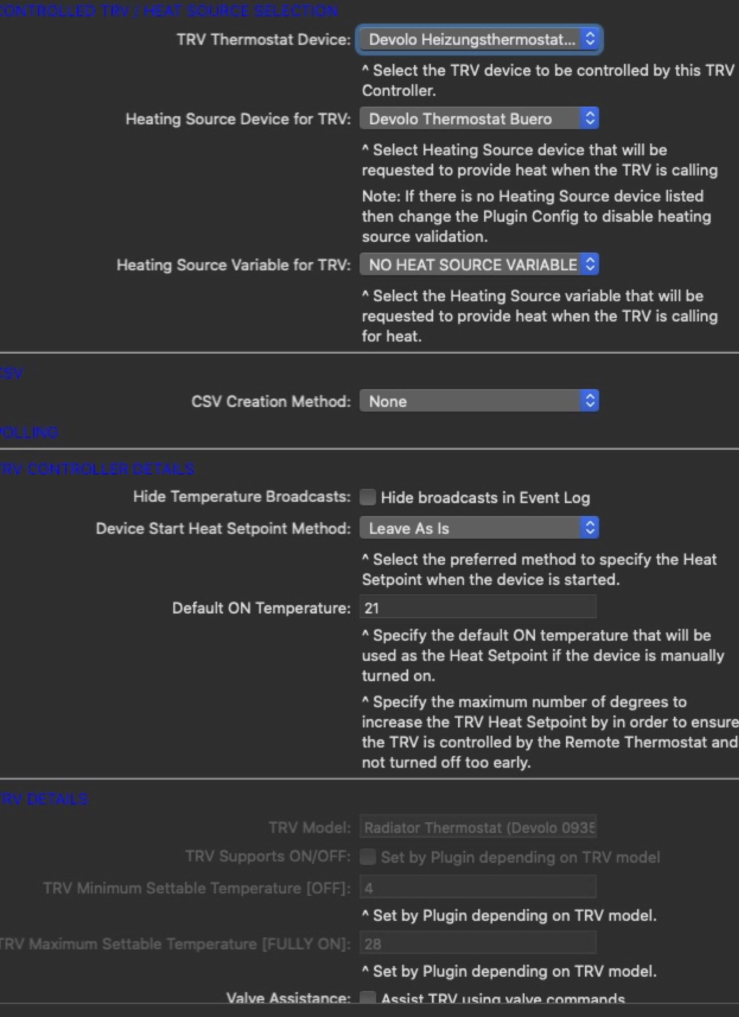

home can I manage it that the heatpoint of a Devolo Thermostat Room Sensor (Link RS) "Devolo Thermostat Buero" will be the heatpoint of a Radiator Thermostat (Devolo 09356) "Devolo Heizungsthermostat Buero"?. At the moment my settings are as attached.

Yes I did it the way described.
Attached my screenshot.

You should set your Devolo Thermostat Buero up as a remote thermostat not as the heating source.
A heating source is typically a hot water boiler providing hot water to the radiator with the TRV. When the TRV or associated remote setpoint is set to a greater value than the TRV or remote measured temperature, the TRV will call for heat i.e. please supply me with hot water.
You need to read the section Remote Details and enable TRV Remote Control.
Hopefully that will get you sorted, if not please post back here.

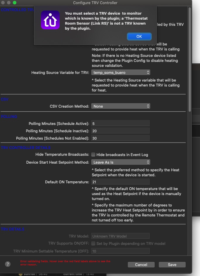

Doing it that way I am getting the error message as shown in my attached screen shot.

You still haven't set it up correctly according to the instructions AFAICS.
Your TRV should be the Devolo 09356 which is supported by the TRV plugin.
Your remote thermostat should be the Devolo Thermostat Room Sensor (Link RS).
The error message is saying that you have specified the Devolo Thermostat Room Sensor (Link RS) as the TRV, not the Devolo 09356.
Make the changes and then post back how you are getting on.
