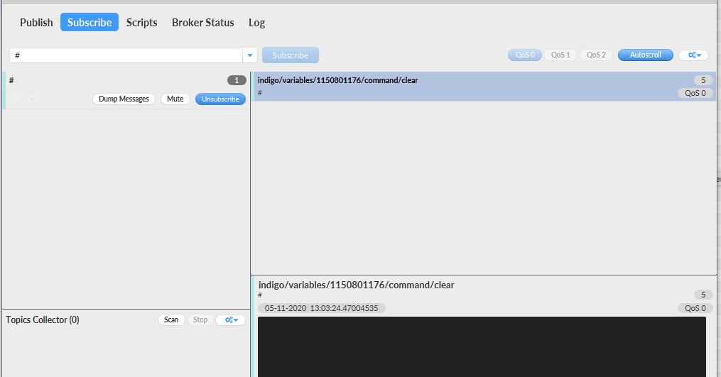

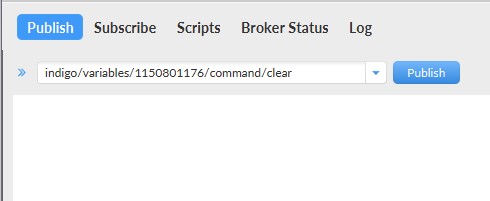

Trying to get the device and variable actions working.
When posting indigo/variables/1150801176/command/clear
Nothing is happening. I don't know if i'm doing something wrong?

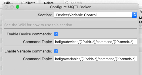

Yes, Trying to clear or edit the variable.

Re: Device and Variable actions
Turn on debug level logging and then show the log entries when you publish that command. Make sure the plugin is subscribed to the "indigo/#" topic (or equivalent subscription).

Yes, it wasn't clear that it also needed a topic subscription.
That was it.
Thanks!
Yeah, maybe I should force a subscription if either of those boxes is checked.
