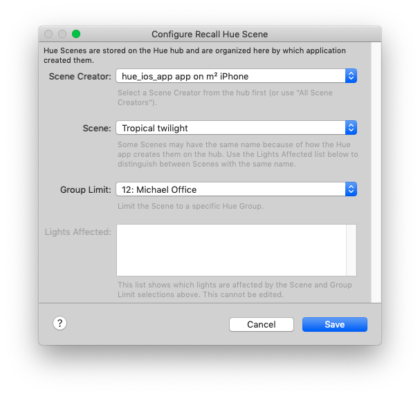

I just installed some Gledopto ceiling recessed can lights (4). I was only able to add them to indigo once I added them to a room - and not able to add them individually - not sure if that's normal or not..
In any case - I'm trying to create an action to recall a scene. I was able to select the the correct scene creator and scene - and the group shows the lights affected - but i get an error when I try to execute:
   Action Group                    HUE Scene Test
   Hue Lights Error                Error in plugin execution ExecuteAction:
  File "plugin.py", line 10899, in recallScene
  File "plugin.py", line 8873, in doScene
NameError: global name 'device' is not defined
Indigo 4.7
HUE Plugin v 1.7.35
Anyone scene this? (pun intended)

Hi.
Thanks for the report.
I can add support for the Gledopto lights. The easiest way for me to do that is to get about 10 seconds worth of debug log output from you. Just turn on debug logging for about 10 seconds and paste the logs into your reply, along with the name you've given the lights within the Hue app. Debug logging can be toggled on and off in the Plugins menu -> Hue Lights -> Toggle Debugging.
As for the scene issue, that certainly looks like a plugin bug. I'll check it out and see if I can track down the problem without getting more debug log info from you. If I can't find the issue in the code, I'll probably hit you up for some more debug logs while you reproduce that error so I can get more detailed tracking info.
Regards,
Nathan

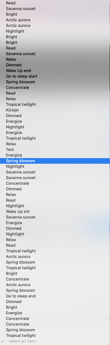

I am no longer seeing the errors. While this is working for my needs - i thought i'd share something with you that I am seeing:
I have 5 "scene creators" in my dropdown (seems to be devices used with other (real) HUE lights in the house
My iPhone is the only scene creator that allows me to select a scene and then my room's group and actually see the 4 ceiling lights appear (This is perfectly fine for my needs)
When I click on the "scene" dropdown, I see 5 copies of each scene that I have on the HUE app on my iPhone:

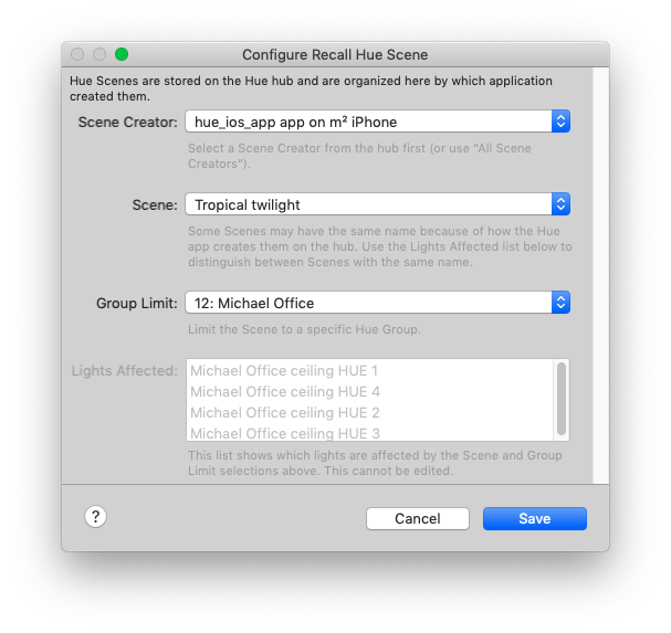

duplicate items.png (463.42 KiB) Viewed 4093 times
Only 1 of each of the duplicates work/show my ceiling lights

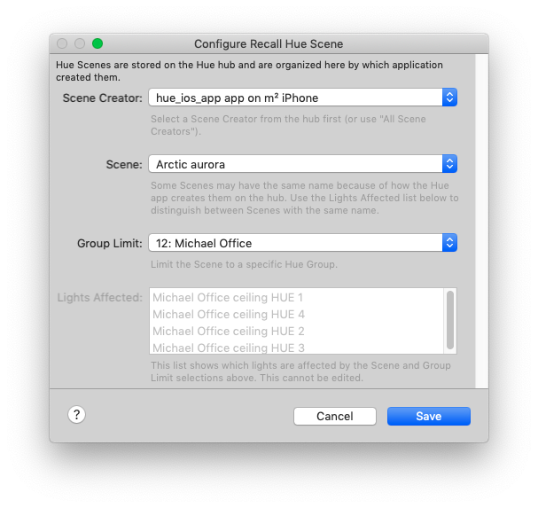

When I select a different copy - i don't see my lights:
scene not showing devices.png (106.39 KiB) Viewed 4093 times

lazlohollyfeld wrote:I have 5 "scene creators" in my dropdown (seems to be devices used with other (real) HUE lights in the house
Thanks for the report. At first glance this seem like expected behavior (at least from my own experience). The Hue app seems to create multiple copies of each scene with different combinations of lights from various rooms in your house. I don’t know why it does this or how to prevent it. That’s one of the reasons the Recall Hue Scene window is so complicated, because I couldn’t find any logical pattern to how scenes in the Hue bridge were organized so I just make all the options available in the dialog box. The Group Limit menu appears to be acting as designed. All that menu does is remove lights in the selected Scene that are not part of the selected Group. So if the Scene selected contains a light from the living room and a light from the dining room, if the Group Limit is set to "0: (All Hue Lights)", you'll see both lights listed and both of those lights will be affected when the scene is recalled. If the Group Limit is set to "1: Living Room" (the number will probably be different on your bridge), only the light in the living room will be affected by the recalled scene. If the Group Limit is set to "2: Dining Room", only the light in the dining room will be affected. Of course, if the Group Limit is set to "3: Bedroom", no lights will be affected because the Scene contains no lights in the bedroom.
