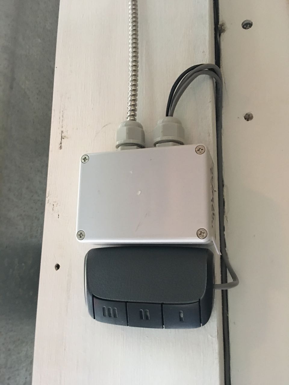

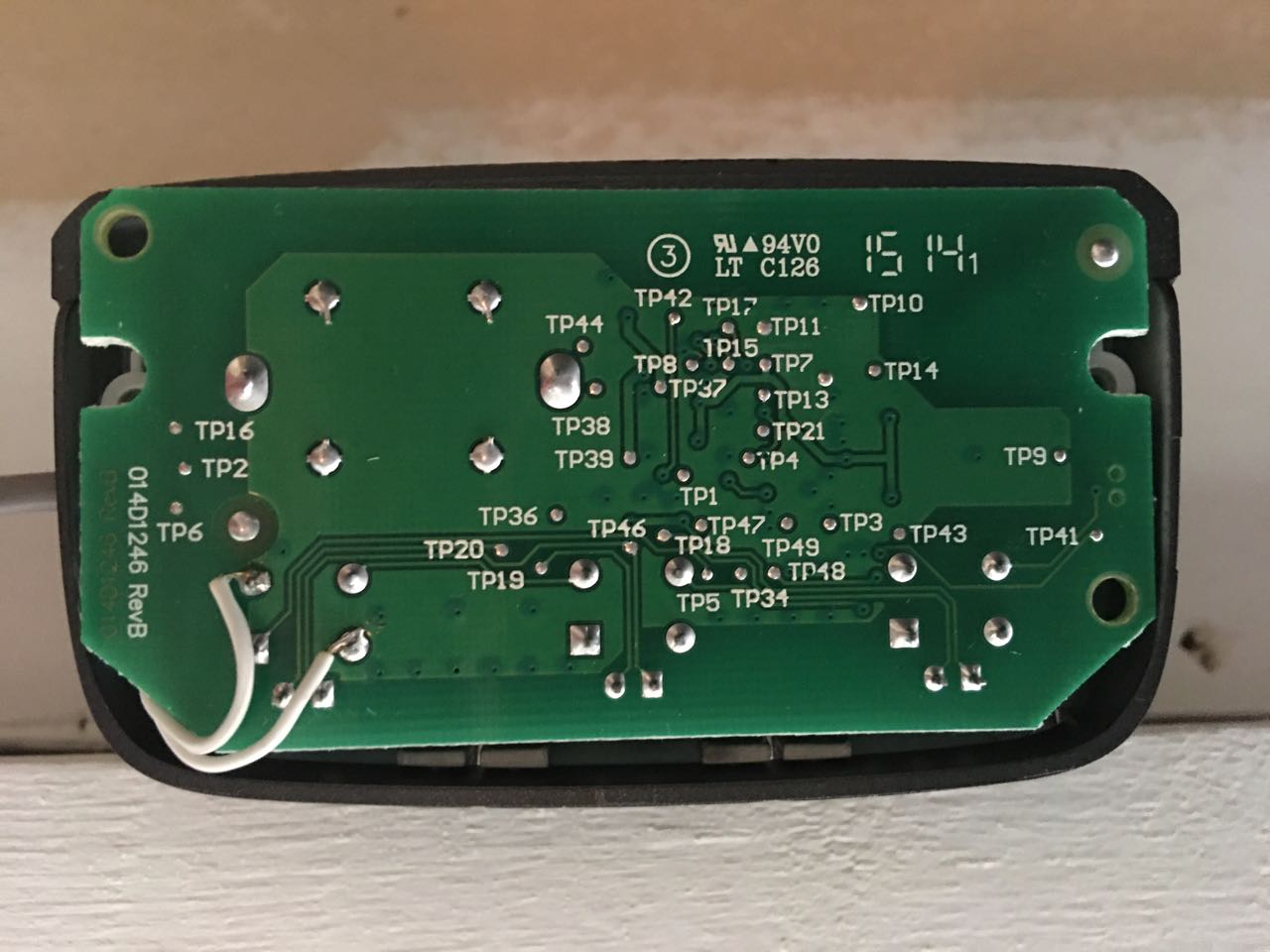

I soldered wires to the contact pads on one of the buttons of an 895MAX 3 button remote. The small key fob size 890MAX would fit nicer but it is what I had. The button wires are then connected to a Shelly 1 relay. The open/close door sensor is connected to the switch contact of the same Shelly 1.
Remote
Remote
I bought my LiftMaster 8500 in March 2016 and this was the option (hacking a remote) I had available at the time. I don't think Joe had his MYQ plugin for Indigo yet. It works well this way and it gives me an extra button right by the garage door which comes in handy when I am working on the cars.
Wall
Wall
Jody
