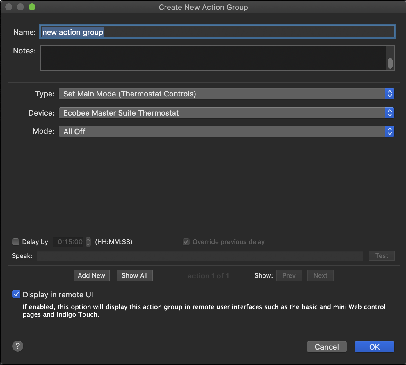

I'd like to purchase a second Ecobee thermostat for a mountain home. When unoccupied, I maintain the house at 5C. Since the minimum Ecobee setting is 7C, I'd like to be able to access the System setting of 'Off". - 7C is an unnecessary heat setting.
Is it possible to use Indigo to set the thermostat to "System Off"?

It's implemented. Is it not working?SMUSEBY wrote:I'd like to purchase a second Ecobee thermostat for a mountain home. When unoccupied, I maintain the house at 5C. Since the minimum Ecobee setting is 7C, I'd like to be able to access the System setting of 'Off". - 7C is an unnecessary heat setting.

Probably is, but I don't see how.
I link Ecobee comfort settings to Indigo action groups, e.g., create a comfort setting for 18C with Ecobee, and then use the action group to run the 18C comfort setting.
In the comfort settings, I don't see a 'shut down the furnace' option.
What am I missing?

Mode = Off isn't a comfort setting. It's a thermostat mode setting.
- Screen Shot 2020-08-29 at 8.06.39 AM.png (220.72 KiB) Viewed 2086 times
