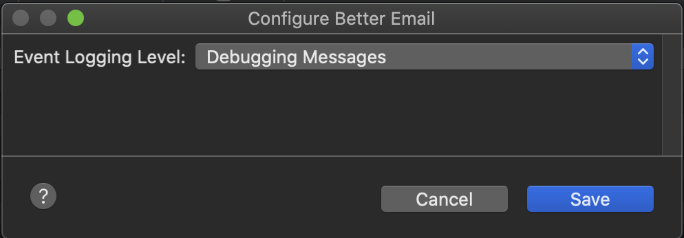

You need to go into the plugin configuration dialog and turn on debug logging.

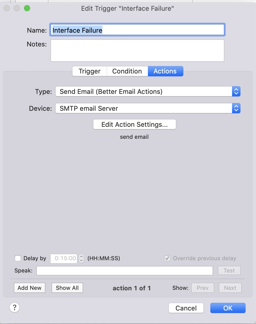

I say it's not working because I'm not receiving emails. Was not getting error in log until I enabled debugging in plugin. Action is configured to Better email device.

I'm not sure what to tell you. Those two lines don't have "Better Email" at the beginning, so they're not coming from the plugin. And I checked - the plugin does not have those text strings anywhere in the code. And they're not in the Python library that's actually connecting to the SMTP server (as best I can tell). Maybe Matt or Jay have some insight into where those two messages are coming from.
