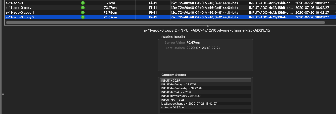

and here w 4 identical devices for the same input port
Screen Shot 2020-07-26 at 18.02.51.png (68.25 KiB) Viewed 6464 times

I do have a couple (well plenty) of sensors on other rpis that are actually disconnected/bad Sensor.
How well isolated to this sensor/pi is that error message?
(Strangely INPUT, INPut_raw all fine....)

2020-07-27 11:27:03 Glenn added : devid:93013512, data: {u'INPUT': 524.25}, whichkeys:INPUT, sensor:ADS1x15
2020-07-27 11:27:03 Glenn added : devid:1123032143, data: {u'INPUT': 522.94}, whichkeys:INPUT, sensor:ADS1x15
1036561108 == status bad sensor, but seems never updated
297270947 == status bad sensor, but seems never updated
1021059064 == Status uptodate & correct
They all have INPUT_O selected - correct one showing key INPUT rest ?INPUT_0,,,,
Ok delete and recreate the devices.
Changed from input_x to just input as each device now has just one channel.
Was done some release ago.
GlennNZ
Posts: 1872
Post by GlennNZ »
OK
Mystery explained - might leave the devices as some are quite well used in triggers/scripts/control pages.. (and INPUT fine)
Thanks again - sorry Karl that was a bit of a wild goose chase..
