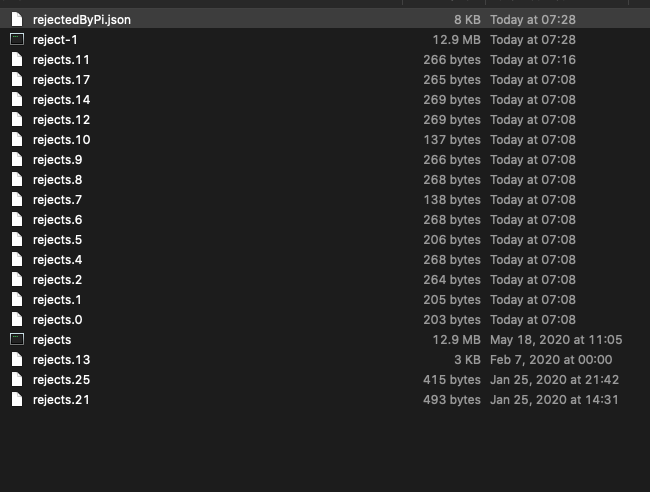

please check directory:
/Library/Application Support/Perceptive Automation/Indigo 7.4/Preferences/Plugins/com.karlwachs.piBeacon/
how big is the file: beacons
/Library/Application Support/Perceptive Automation/Indigo 7.4/Preferences/Plugins/com.karlwachs.piBeacon/rejected
how big are the files?
the biggest file is likely: rejects that contains the history of all rejects that can be long - mine is 12.9 Mbytes (reject-1 is teh backup copy)
reject.0 ...x are the files from the RPIs
these you can simply delete,, they used only for stats
The file that is used the the menu is rejectedByPi.json
you can delete that one (stop plugin, then delete, then restart plugin). That will erase list of deleted files
here my directory:
Screen Shot 2020-05-20 at 07.58.40.png (75.07 KiB) Viewed 2957 times
