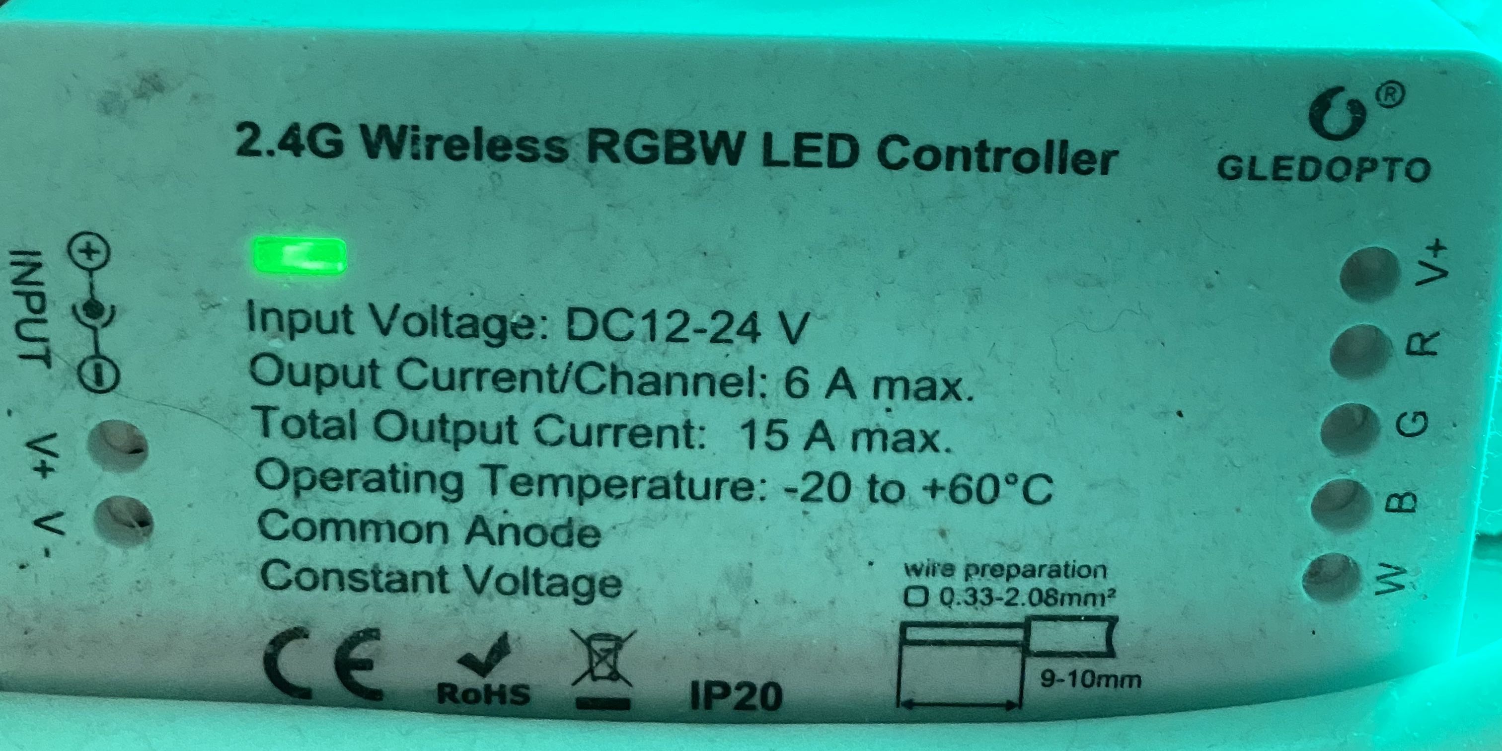

In the Hue iPhone app, both Colour (color) and hue controls are available, although the hue control acts a bit odd perhaps due to the lack of a W wire connected on the controller shown below:
