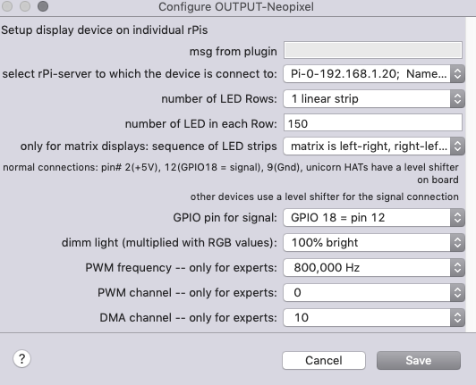

1. create an output device neopixel with n LEDs (here 150)

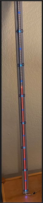

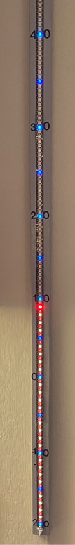

3. connect the neopixel strip through a level shifter to pin# 18=digital PWN out, +5V GND -- and on the neopixel side GND,+5V, Di
The neo pixel strip is mounted on a plane long piece of wood

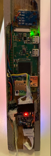

The electronics in the back:
Screen Shot 2020-01-16 at 21.54.21.png (164.54 KiB) Viewed 7471 times
from top to bottom:
1. light sensor (top) connected via i2c, the light sensor regulates the LED power. It "looks" through a small hole in the wood panel to the front
2. pi zero W
3.Signal level shifter 3.3V --> 5V. You only need to connect pi to (+5v, ground, signal) , and (+5V ground sig-out through 470Ohm resistor) to Neopixel chain
4. standard USB power supply
Mounted the whole panel (> 1m long) on the wall in the kitchen "outside temperature in ºC":
