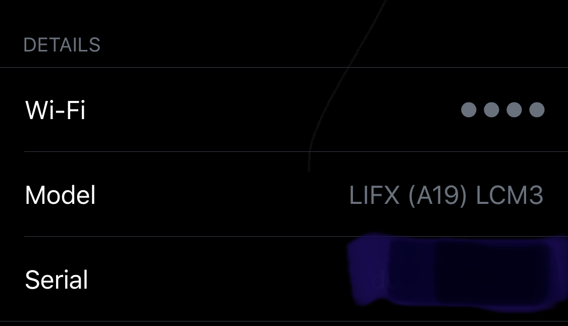

Clutching at a straw here but I think that the issue might be that A19 not being recognised is a new sub model LIFX (A19) LCM3.
I googled on LIFX A19 "LCM3" and came across a few recent posts reporting problems with other systems.
Have you got any other A19s and if so what are their model types?

Oh, that might be it. This was the first A19 device I bought from LIFX it was part of their holiday promotions.
Bollox. I was gonna include it in my NYE party lighting along with the rest of my devices.
Oh well.
Thanks for the assistance!
Oh well.

Hi Andrew,
I don't think it will immediately fix your issue but hopefully it will identify if your new A19 is not in the LIFX product table. If that is the case a message will be output showing the product Id and I should be able to add it into the plugin.
I have uploaded a new version of the plugin to the Indigo Plugin Store.amannone wrote:Oh, that might be it. This was the first A19 device I bought from LIFX it was part of their holiday promotions.

Hi Andrew,
I have uploaded another update to the Indigo Plugin Store which has an updated definition for your new A19 LIFX bulb.
Hopefully it will work for you.
