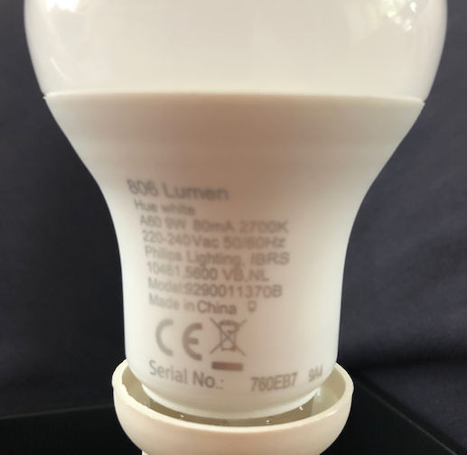

Hi Nathan,
Thanks for your reply. It is a dimming-only light and I think it is just an e27 hue white in this 'Lucca' lamp.
Best regards, Gerrit Jan
P.S. Photo attached
P.S. Photo attached
