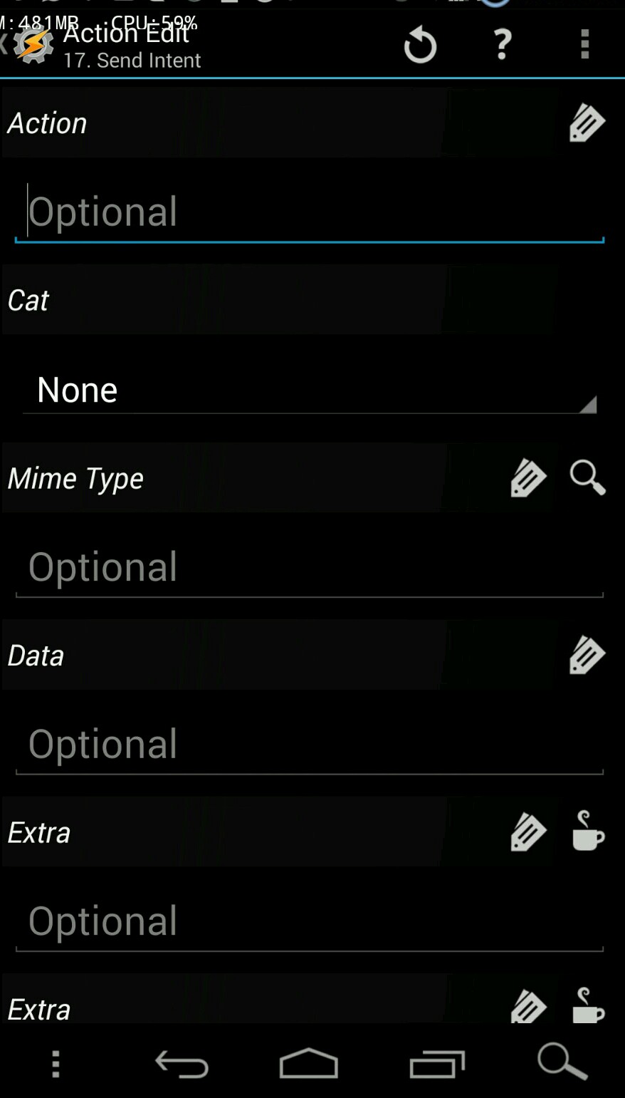

For quick access I really enjoy the widget feature which allows for creating Action Group shortcuts onto the home screen
Is there a way to activate these AG shortcuts via Tasker once they are on the home screen?
T.I.A.
It has been years since I used Tasker, but IIRC there is a way to launch an arbitrary Intent, correct? If so, is there any option to specify "EXTRAS" within the Intend that will launch?

This looks like it.
Now what? :)

This looks like it.
Now what?
I'll try to capture you what you'll need for the EXTRA in order to execute the action. I am pretty sure that we can execute it that way... not 100% positive, but pretty sure.

I still haven't been able to figure out exactly how to represent the "Parcelable" object in Tasker's intent. If you want to play around with it, the only value that is technically needed is "indigoItemId" (a long int representing the Action Group to execute). There are other values that may or may not be stored (empty). The issue is that I can't "see" it in the same format that Tasker is wanting it represented.
I can see about adding a new option to simply pass in the ID as a number if you can't figure out how to represent it...but maybe the Tasker forum/support can provide a sample Parcelable format for you?

Okay... I don't have Tasker so can't really test this, but assuming you have the latest version installed (specifically v1.5.3), you can give this a try...
Extra:
IndigoActionGroupId:[ACTION_GROUP_ID]
Let me know how it goes...
