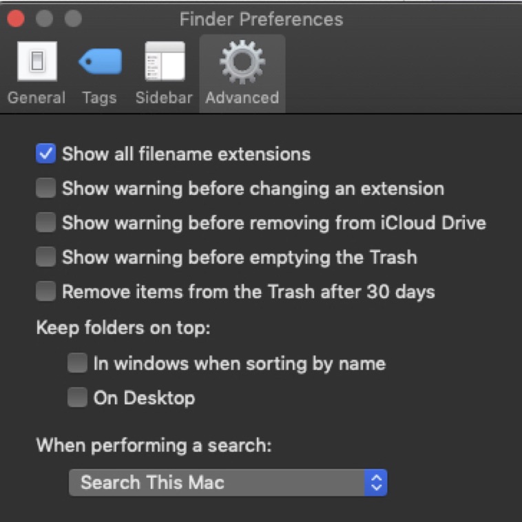

You might have "Show all filename extensions" unchecked in the Finder.
Choose menu item [img][img][/img][/img] Finder >> Preferences >>and then clicking on the Advanced tab.

No, it's not unchecked and still very confused.
Carl
