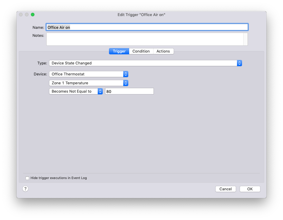

I'm looking to pair my Nest with a window unit and smart plug.
Attached is my simple trigger, but it doesn't seem to work. Is "Zone 1 Temperature" not "the temperature in the room right now"? If not, what should I be using in its place, to get the Trigger to work successfully when the ambient temperature reaches a certain temperature?
- tnu5y.png (119.18 KiB) Viewed 4773 times

Re: Trigger based on current ambient temperature?
The becomes not equal to definition will only fire when the temp is exactly 80 then changes to something else. Not sure that's what you're looking for. You never actually describe the scenario fully, so it's kinda hard to understand what you want to happen. A more clearly defined scenario will help us guide you to the right solution.
I think I grabbed the wrong screenshot.
I have “becomes equal to” in my Trigger. That should Trigger when the temperature hits that point, right?
I’ll then have another trigger to turn it off when the temperature hits 74.
Am I correct that “Zone 1 Temperature” is what I think it is? Also, this is all not worth it because Google is shutting down the Nest APIs soon and the plugin will stop working anyway, right?
Not necessarily. You still haven't described the scenario, but I think I can guess: If the temp goes above 79 (greater than 79, so in whole numbers 80 or more) you want the other thing to turn on, and when it becomes less than 75, you want the other thing to go off, right?mikejandreau wrote:I have “becomes equal to” in my Trigger. That should Trigger when the temperature hits that point, right?
If this is correct, then you need to define the triggering events like this:
- Office Thermostat, Temperature Zone 1, Becomes Greater than 79 (basically 80 or above, though if the Nest reports in fractional degrees it'll kick on a little sooner)
- Office Thermostat, Temperature Zone 1, Becomes less than 75 (anytime it crosses the 75 threshold)
I can't answer your other question since I don't have a Nest and don't know how it's implemented.

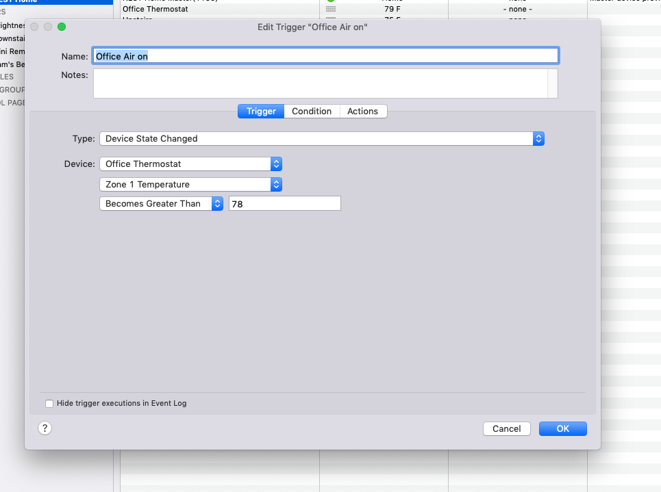

This is what I’ve got now, but wasn’t working today.
I think the issue is that Indigo isn’t polling the “State” frequently enough from the Office Thermostat, so it can jump from 77 to 79 in one refresh and that doesn’t trigger the Trigger.
I’ll keep an eye on it tomorrow when I’m in my office all day.

Doesn't look like this is working, unfortunately.
You can see in the top of my screenshot that my Office Thermostat is 79F now and my Trigger is "Becomes Greater than 78" but my trigger didn't trigger.
Chipping in
I suspect that might be because the state you are comparing against is a text string of '79 F' and therefore not numeric?
Is there a numeric only custom state that you can compare against?
