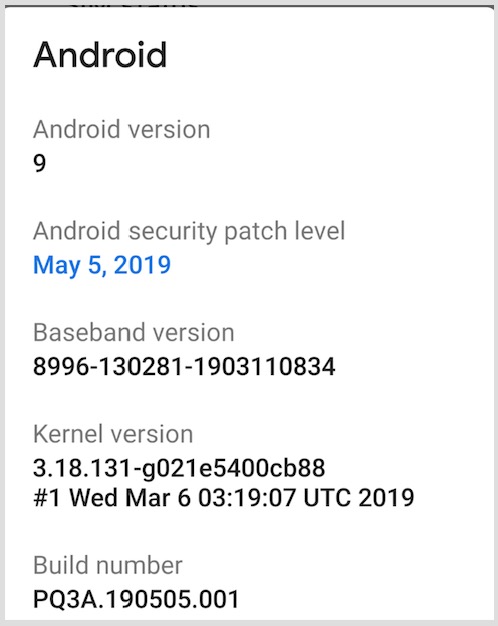

What OS version is her phone showing?

Details below - funny we noticed that voice works but if the phone is face down all we get is the notification sound - not a big deal on the voice maybe that is her settings. Would like to get the geo thing working if possible so I can integrate it into my home/away process.

Hmm, our build number is virtually identical, just one .001 off, though my Pixel 3 XL has a higher kernel version. I wouldn't imagine that should make a difference. I'll try to check my wife's Pixel and see if she has similar and test it out on that. She doesn't have geofencing enabled, but I'm sure would let me test it out (or not even know... she hates change on phones so maybe shouldn't tell her LOL).
