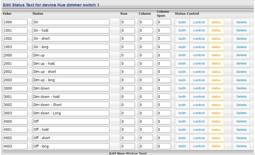

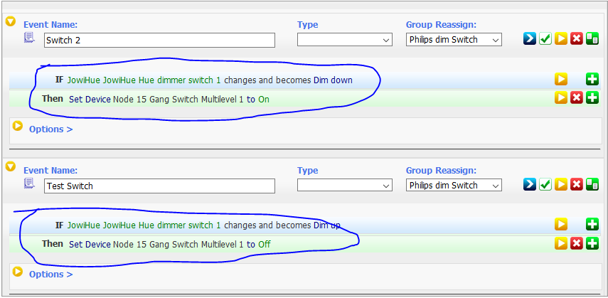

I found a homseer user that its using this feature via JowiHue plug-in, i asked him and he confirmed that he is using it to control devices/actions via triggers ..so i belive its doable.. but how... i dont know.
Here some screen shots
The first shows its possible to do short press, long press etc.
The second is switch off and on a device.
Maybe hue communicate i different way with homeseer... i dont now
