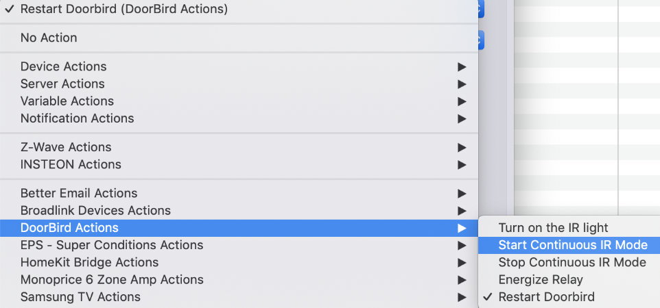

After enabling the feature did you start it from the action menu of the schedule / trigger?
Monosnap 2019-03-25 08-19-54.png (564.31 KiB) Viewed 4221 times

Post by kwijibo007 »
Strange that it's not working as it uses the same code as the one-off IR trigger.
I'm using a different version that I've not released yet (I've been using it for months). I just PM'd you a link, could you please try this version? I can't see why this would fix it (unless I previously fixed an issue that I now can't remember :shock: )
