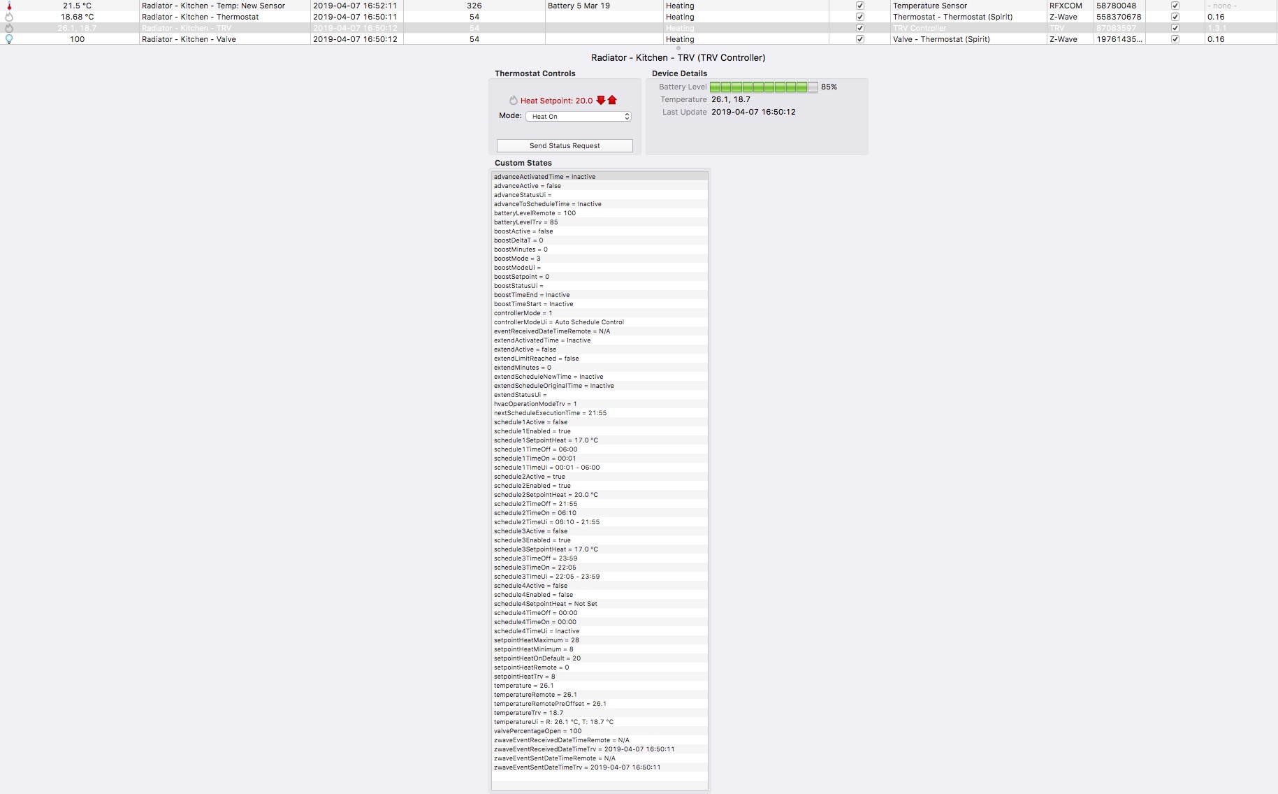

Hi
Running 1.3.1
The Kitchen is constantly overheating - Could be sun coming through windows, cooking/dishwasher/washing machine/dryer..
But oddly the TRV Valve remains open at 100% with occasional dips to 0%
Any clues - does it need a 'whack'
TRV Radiator Kitchen - Valve stuck at 100%.jpeg (233.5 KiB) Viewed 5482 times
Any ideas?

I think I have sussed it
The Spirit TRV was in INS mode!!
I pressed the action button and off it went and shut down the valve.
Seems to be working now.
Odd that it was reporting temp/valve etc but sat in INS mode.
I'll keep an eye on that and walk around the valves a every few days see if they are Ok
Anyway to remote detect it in INS mode?
