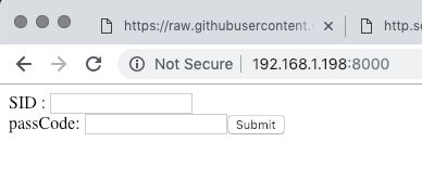

and here how the http page would look like
Screen Shot 2019-01-06 at 22.54.14.png (15.71 KiB) Viewed 1651 times
then master.py would grab that info and would compose the proper supplicant file and put into place and reboot. .. and then the RPI would connect to the home internet through wifi
