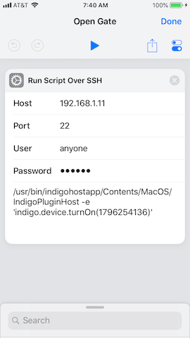

As a solution for when you are connected to your LAN, you can configure your iPhone and Siri to perform the action you discussed, with a single Siri Shortcut Action; "Run Script Over SSH". That is the scripting option you would start with.Couple questions: When creating the Shortcut on iPhone, at "Add options from the bottom to build your shortcut," which Scripting option do you start with? Also, if I need SSH server enabled on the iMac, where/how do I do that? I'm open to installing Pythonista on the iPhone, if that's convenience. I will mostly be invoking this command while on WiFi on my own LAN but I might want to invoke it from WAN, as well, if that changes anything.
SSH needs to be enabled on your iMac running. On your iMac -> System Preference -> Sharing, then check “Remote Login”.
To avoid frustration, test that you can SSH into your iMac running Indigo from another Mac. To SSH into a device, the format would be: "ssh username@192.168.1.55"
You will be prompted for the password for that username. The very first time you log in, you will be asked host to accept a public key from the remote host, answer YES.

Once you're able to SSH into your iMac from another machine, then build the shortcut as shown below, and then test that. Ensure you input your username and password. The same ones you tested as instructed above when SSHng form another machine.
- IMG_3107.png (45.17 KiB) Viewed 5630 times
