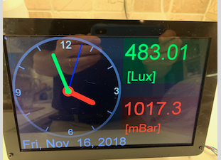

     ',{"type":"analogClock", "position":[355, 350], "width":64, "font":"Arial.ttf", "offONTime":[0, 999999999, 0], "display":"immediate", "box":{"on": "circle", "width": "30", "fill": [100, 100, 100]}, "mm":{"fill": [0, 255, 0]}, "ticks":{"fill": [150, 150, 150]}, "ss":{"fill": [0, 0, 255]}, "hh":{"fill": [255, 0, 22]}, "radius":[340, 340], "mode":"lineRound,,TicksNumbers"}]'

this will show an analog clock on the left,
date at the bottom
and 2 blocks of sensor data on the right hand side, those will switch every 2 seconds ( "offONTime":[2, 2, 4], == 2 sec off, 2 sec on, 4 sec off)
Screen Shot 2018-11-16 at 15.58.27.png (132.42 KiB) Viewed 1781 times
