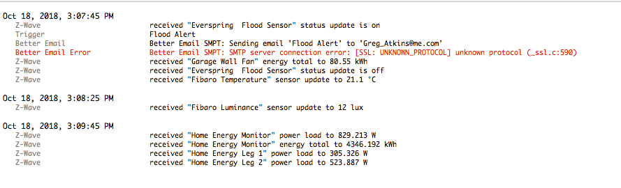

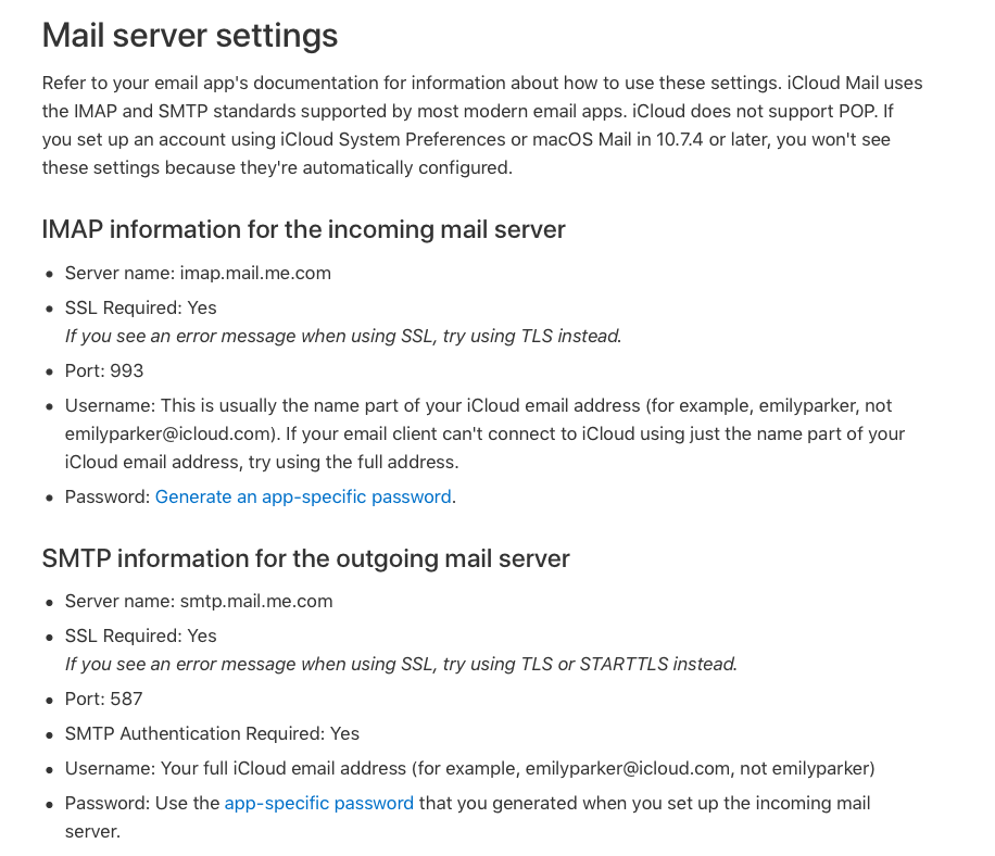

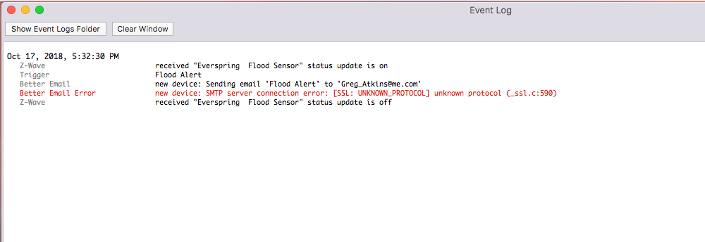

So I have installed the plug-in, created an IMAP & SMPT device and configured them with the settings from the Apple support website.
I'm getting what you see in the event log...any thoughts??

I suspect that this might be another manifestation of the deprecated TLS issue with Sierra (and earlier). Looks like Apple is ahead of the pack for email servers.
Do you get the same error with the other authentication methods?
If that's what it is, the only solutions I know of are to upgrade to High Sierra or later, or use a different email provider.

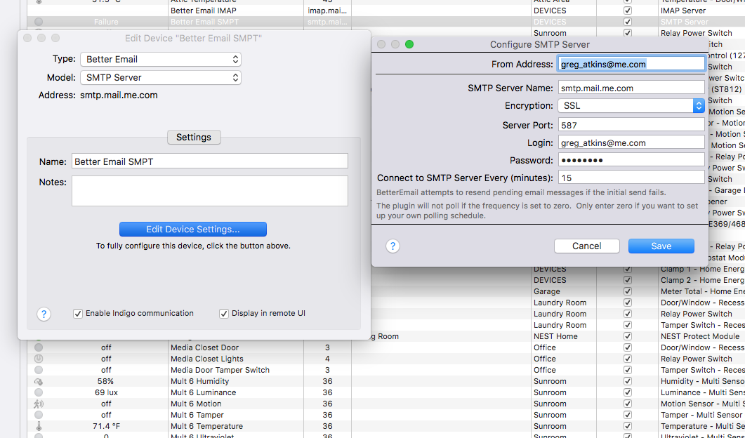

Attached are screenshots of the IMAP & SMPT setup dialogue boxes and a fresh event log of a trip of the flood sensor.
The password is still not app specific (how do I create an App Specific password)? I can type in one here in each dialogue, but doesn't that password have to be
set up somewhere else for validation when Indigo tries to access said email?
Anyhow, we can deal with the password issue as things progress...in the meantime, have a look and see if you can spot the culprit at hand...

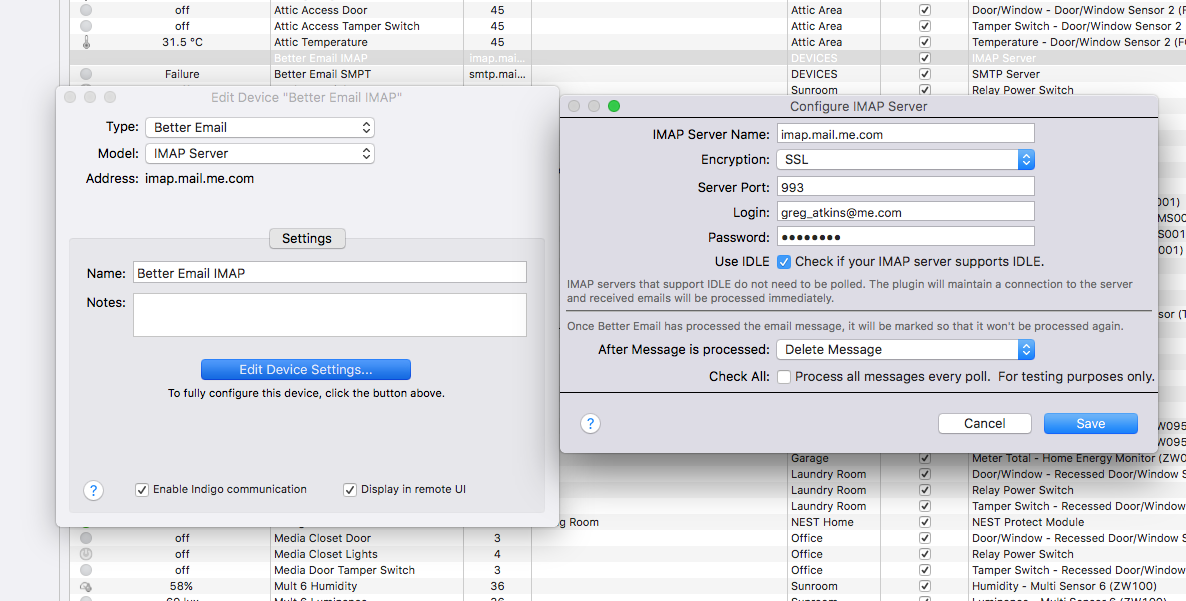

- Screen Shot 2018-10-18 at 3.08.37 PM.png (229.32 KiB) Viewed 7060 times
- Screen Shot 2018-10-18 at 3.09.01 PM.png (232.12 KiB) Viewed 7060 times
- Screen Shot 2018-10-18 at 3.09.41 PM.png (66.78 KiB) Viewed 7060 times

For the SMTP server, change the Encryption pop-up to StartTLS.

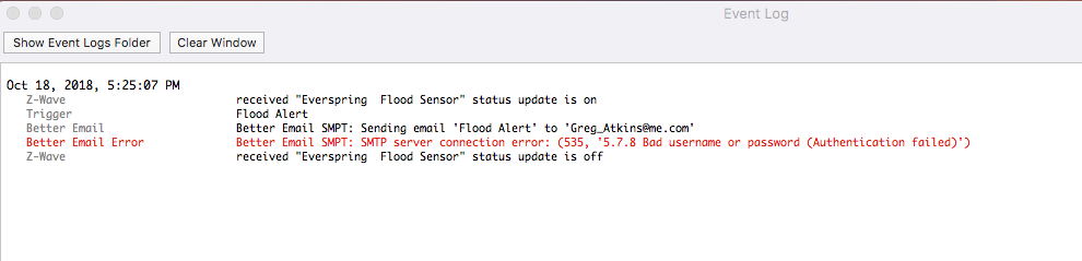

Re: Setting up iCloud Servers...

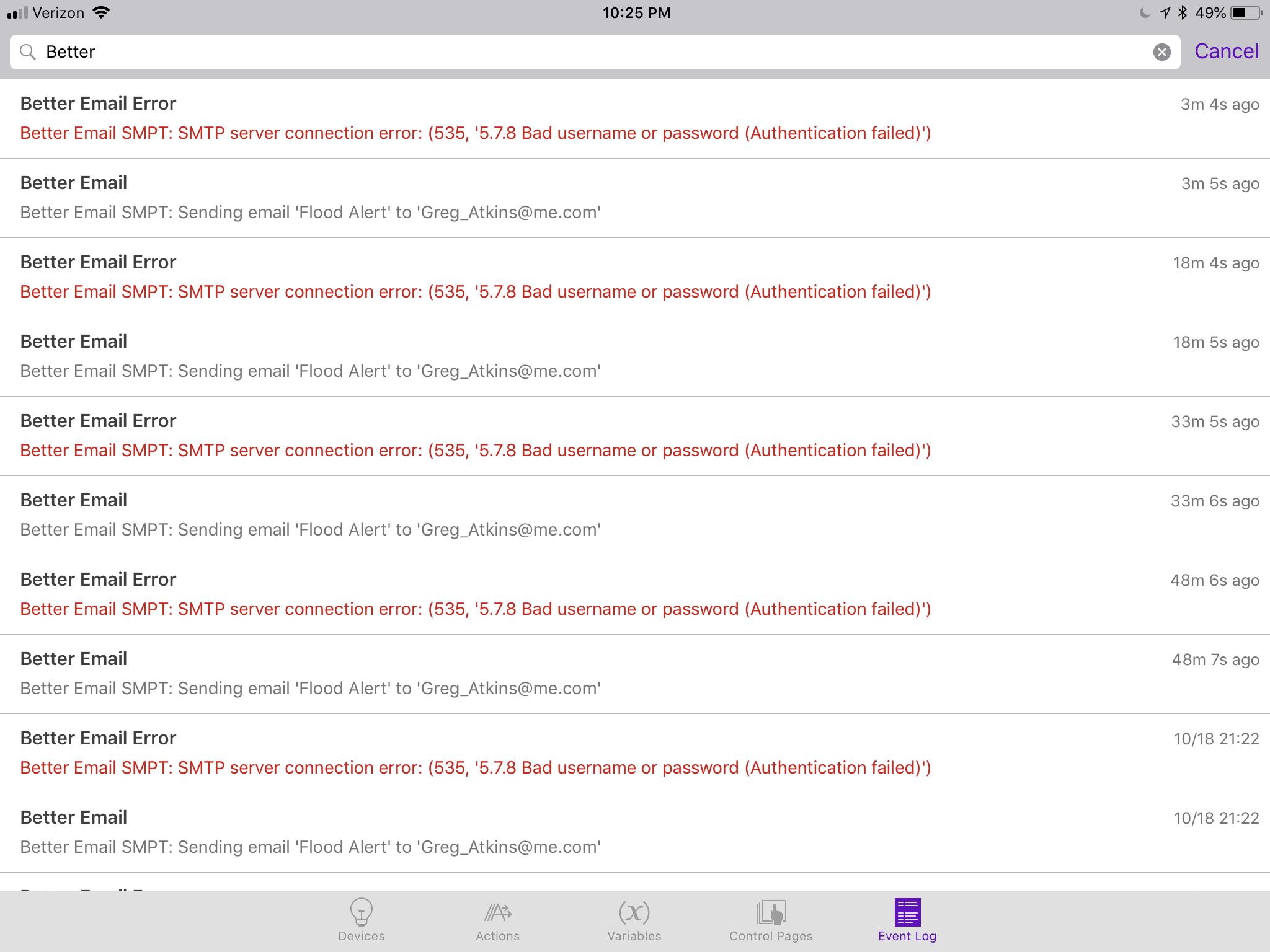

Ok, now it looks like we've drilled down to the password issue, log shows an authentication error....I see in the SMTP and IMAP setup dialogues where to enter a password, but where else is it necessary?
- Screen Shot 2018-10-18 at 5.25.35 PM.png (38.29 KiB) Viewed 7038 times
- Posts: 7830
No where, but it can't be your normal iCloud login password. It has to be an app-specific password. As explained on that support page you were referencing in your first post.Gman34798 wrote:Ok, now it looks like we've drilled down to the password issue, log shows an authentication error....I see in the SMTP and IMAP setup dialogues where to enter a password, but where else is it necessary?
No luck after changing passwords
I'm not sure what to tell you. It does work if you correctly obtain an app-specific password for that iCloud account (at appleid.apple.com), and put it in the device configuration dialog. I just did it this morning as a test.
This is what I’m missing. I’ll do this tomorrow and be good to goFlyingDiver wrote:...obtain an app-specific password for that iCloud account (at appleid.apple.com), and put it in the device configuration dialog.
Will post results once done, thanks for your patience with my ignorance
Thanks again Joe,
Password did the trick!
