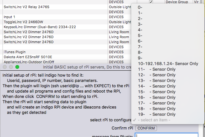

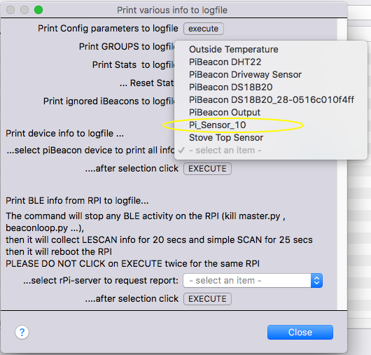

I have been using your piBeacon plugin in the sensor only form. It works great with the various sensors and inputs I have thrown at it so far. I shut my entire system down for a day to relocate and since bringing everything back up I am seeing following error: calcPitoPidist in Line '2047' has error=''key PosXYZ not found in dict'
It does not seem to have any adverse effects on the use of piBeacon as I am using it but seeing the error every 20 seconds in the Indigo log.
I captured an example of portions of the Indigo log file and a couple of the config files. Appreciate any guidance to resolve. Thank you for your time and efforts.

printing dev info for Pi_Sensor_10/879036091 -------------------------------

Karl,
That fixed it. This plugin and your continued support of it are amazing! Thank you.
Regarding the other Pi that is not properly defined....When I started using the piBeacon plugin I started with all the services using iBeacon support and the rpi was on #1. I moved that rpi from 1 to 10 for the sensor only support.
Unlike you, I had no idea what I was doing but got it moved and maybe my methods botched something along the process? I haven't had any issues with piBeacon though except for this very recent issue. I have looked through the piBeacon plugin menus and do not see any reference to a pi other than #10.
Jody
Jody
- Screen Shot 2018-09-17 at 9.34.49 AM.png (118.92 KiB) Viewed 3311 times
Re: PiBeacon 2047 Error
Can you go to initial setup and check if there is anything for pi#0 1..
If so disable it
Could you email me the file RPIconfig in ~/indigo/pibeacon
To Karlwachs at me dot com
If so disable it
Karl,
Do not see any other pi's listed in the initial setup. Sending email.
Jody
Jody
Karl,
I should have said the pi was originally on 0 not 1.
In the rpiconf file I emailed, I see that the "piDevid":879036091 still remains on "0":
It is the same "piDevid": that is currently in use on "10":
Jody
Jody
