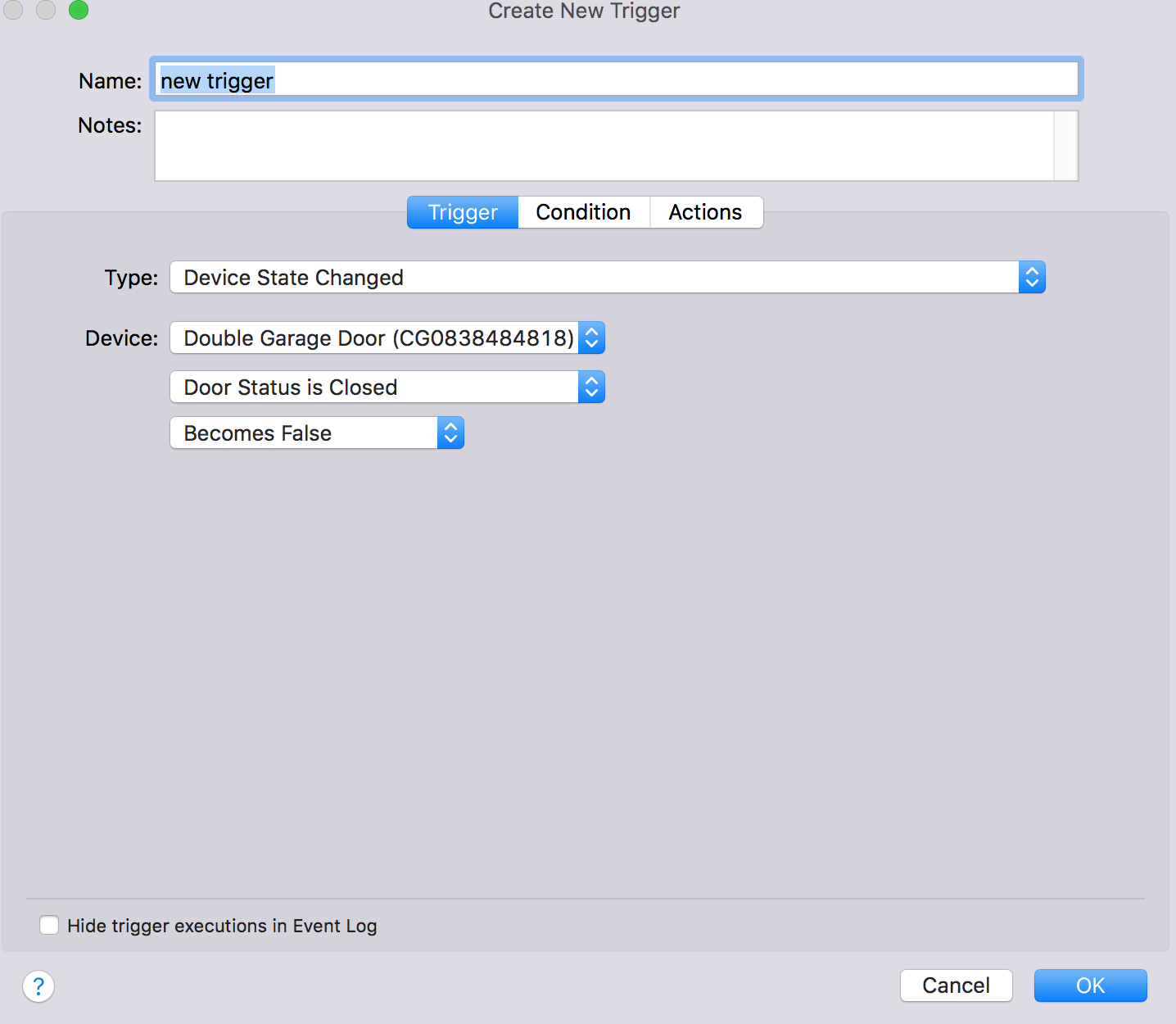

You want to trigger on the device state changing. The easiest way to do what you want (I think) is to trigger whenever the door changes from the closed state.
Don't forget - the plugin has to poll the MyQ servers, so there can be a long delay until the door status updates and the trigger fires.
I use the plugin to control the door, but I use Z-wave tilt sensor to detect movement. The plugin has provisions for that, and if the tilt sensor doesn't match the reported state is when that mismatch trigger fires.

- Screen Shot 2018-08-17 at 6.15.15 PM.png (122.45 KiB) Viewed 3459 times
Re: What's an example of a useful configuration?
OK, that worked but like you said, it was a long time for a response. I guess I'm going to have to get another I/O Link in, that is instantaneous. Under the Edit Device Setting it brings up a Sensor Device which I assume would be for Z-Wave Tilt sensor. I've got several I/O devices that show up in that field. Can an I/O device be used or is Z-Wave the only thing that works here?
