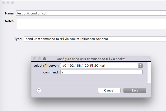

Re: Node-Red
you can also do a pibeacon action:
Screen Shot 2018-07-17 at 09.28.11.png (49.95 KiB) Viewed 2075 times
you can send any unix command to the RPIs this way, but you will not get any answer back
