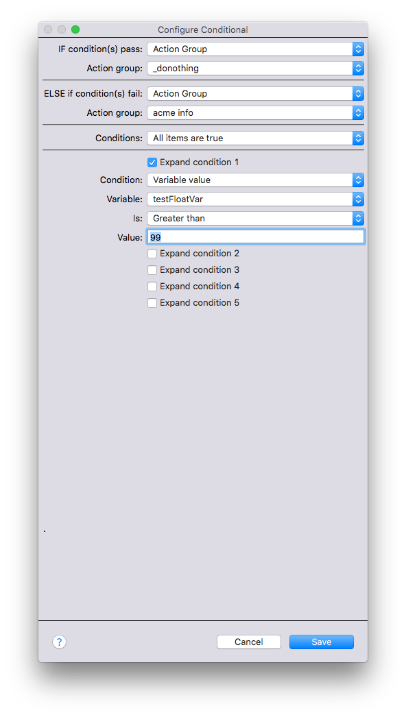

Hmm, interesting. Can you do a screenshot so I can try to exactly replicate what you are doing? I'm sure I can find what the issue is and fix it.

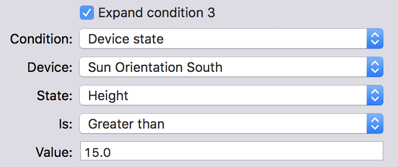

I do have another failed condition now; it gets to the right conclusion, but one condition is wrong, the log gives this result:
Checking if device state 'height' value of '8.81' is greater than '15.0'
EPS - Super Conditions Debug Condition 3 returned [1, 0]
It supports my theory that its just a string comparison, starting at the first char, "8" is greater that "1"...

That's on the new version? While my test is using a variable value the computation is identical.
EPS - Super Conditions Debug Checking conditions on 'Non Indigo Device Object'
EPS - Super Conditions Debug Condition is set to alltrue, testing condition(s)
EPS - Super Conditions Debug Checking if variable 'testFloatVar' value of '113.37' is greater than '99'
EPS - Super Conditions Debug Condition 1 returned [1, 0]
EPS - Super Conditions Debug Conditions returning true: 1, returning false: 0

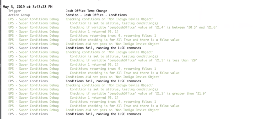

Sorry to resurrect an old thread but I am running into something similar here with the latest version from the plugin store.
I have some Sensibo AC controllers and setup some basic conditions to change the mode across fan/heat/cool based on some temperature ranges.
I'm attaching a screenshot of the log showing this - but I have a condition setup to switch the unit to fan only mode if the temp is between 20.5 and 21.6 C. Similarly, it will switch to cool if the temp is above 21.9 and heat if it is less than 20. The temp value changed to 21.4 and the conditions were evaluated, and they all returned false.
- SensiboCondition.png (385.51 KiB) Viewed 4120 times
