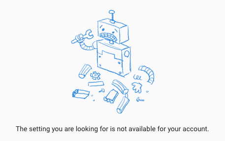

Well, according to google I have Visit your App passwords page. You may be asked to sign in to your Google Account.. I do that, and then immediately get
Screen Shot 2018-05-22 at 18.41.55.png (32.16 KiB) Viewed 4539 times
I guess I'll just manage with my less secure app :D

FWIW, and for posterity, I was able to get time and actually do a bit of research in some of the developer docs -- looks like the main culprit are applications which are directly signing into Google and thus likely have your password stored. The two main workarounds are to either change the application to use OAuth for authentication OR enable 2-factor authentication and utilize the app-specific password. Obviously only the latter is a feasible solution from an end user perspective.
Berkinet - that App Passwords setting isn't available without 2-Factor Authentication enabled, perhaps that is not enabled on your account?

I honestly wouldn't worry too much about it -- the App Password works fine with the plugin and users really should enable two factor authentication anyway (and thus have access to the application passwords)! :-) One caveat, I believe the OAuth applications that I have seen are using the JSON API...

The answer seems to be to enable 2 Factor Authentication and then using app-specific passwords.
