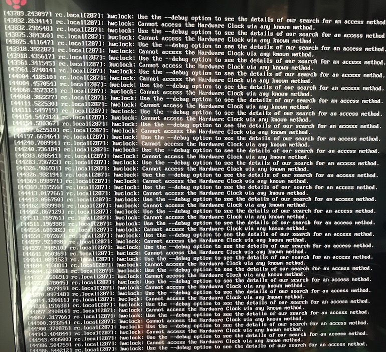

I have set the correct settings in the config for the pibeacon "No HWClock". This fills the output from the device and it seems to render it non-responsive to indigo as well. Also when I use the "restart NTP connection to get time from internet" button on the "Send Config/Restart/PGM/Sound/... to rPI server" dialog I get "sh: 1: refreshNTP: not found".

Re: Cannot Access Hardware Clock via any known method
it looks as if the regular clock was uninstalled....
here is what master.py is supposed to do to reinstall the regular clock:
so could you do :
remove dtoverlay=i2c-rtc,ds3231 from file /boot/config.txt
remove /sbin/hwclock -s from "/etc/rc.local
with sudo nano filename
and file /lib/udev/hwclock-set should look like:
then do:
and
to reinstall regular clock .
I actually really tested well install l HW clock , and may be once to remove it ..
or redo the SSD and push the regular config/pgm to the RPI.
The IP number etc should be all ok.

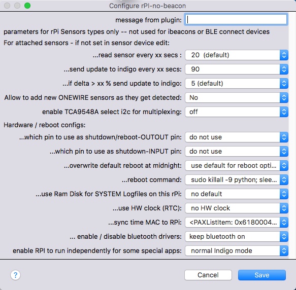

So I wiped the microSD and was able to reproduce the issue. But this is with the existing device object created in indigo. So I deleted the device in indigo, then cleared out the rPI in the initial setup screen. Re-imaged the microSD. This time I did not open the created device in indigo until I had completed all the setup steps called out on the main how to create an microSD blog post. This time it seemed to have worked. I did take a screenshot of the initial load of the device dialog once I had setup the rPI and configured it (ie. expand disk, timezone, change pass, and change hostname). It is below.
Also attached are the parameters files you requested. I didn't get your message until after I had deleted the device in Indigo, however, Synology Cloud Station Server keeps 23 versions of my files now (this was implemented after I was loosing piBeacon devices after upgrades). So I went and hunted down an old version that would have been active when I was having the HWClock errors. The only large difference I see in the files is the extra json data for the sensors.
Thanks for bouncing ideas! My only take away on this is...don't open the indigo device until after all the setup of the rPI has been completed. My next issue is around the usage of "myprogram.py" and "mysensors.py". I will open a new topic
