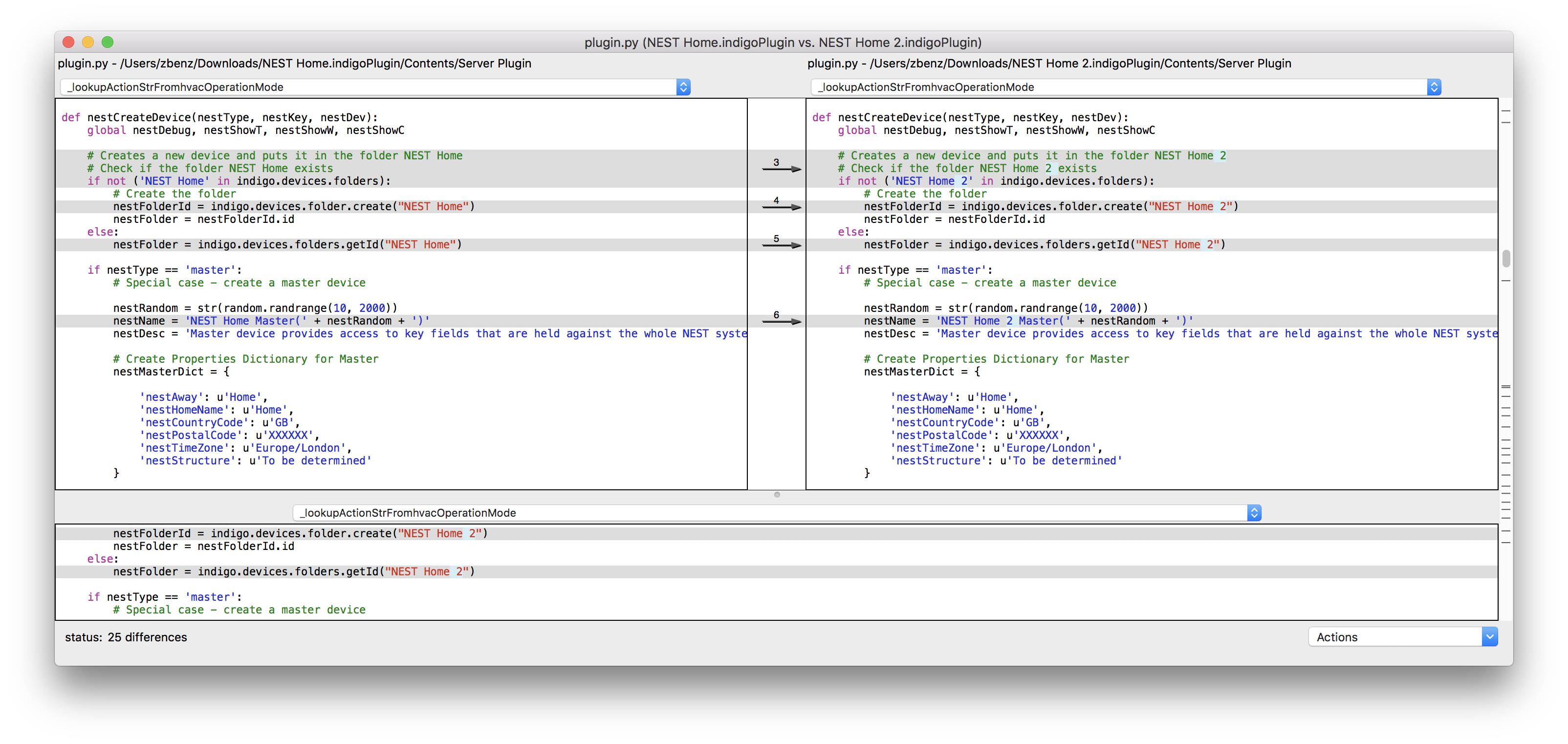

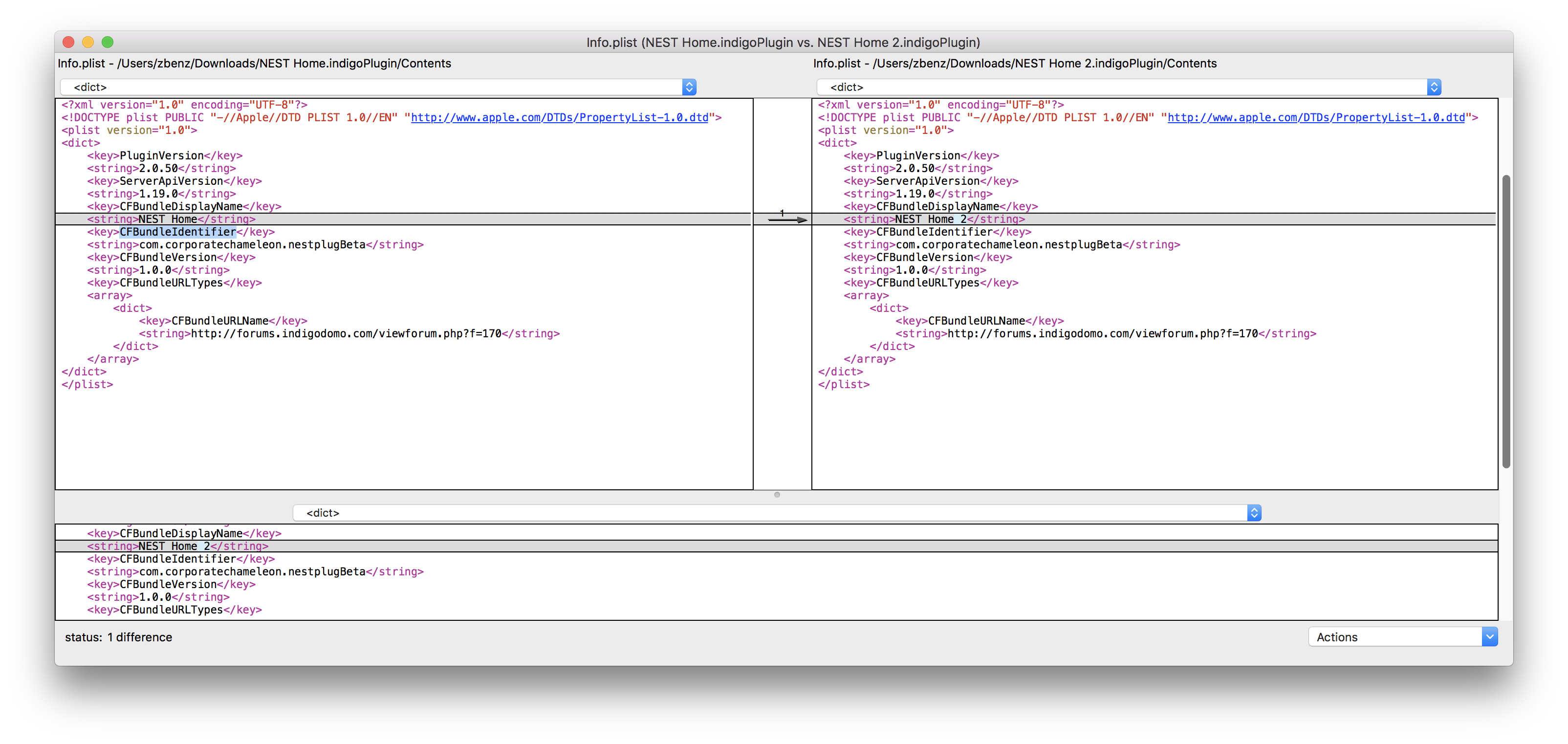

The purpose of Nest Home vs. Nest Home 2 and Nest Home 3 is to allow you to talk to multiple Nest houses from one Indigo server.lanbrown wrote:'jay (support) wrote:I have no clue what those were or how they worked or what difference there was between them. I just added the one without a number to the store and to Github. Someone else will need to figure out that those are about and combine them into a single plugin release.maslett wrote:is there versions for multi-locations ie Nesthome2 and nesthome3 like the original plugin.
I thought they were for if you had more than 10 devices. If the only thing that was changed in the the one without a number was the update checking info, then there shouldn't be a need tp update the other two.
I grabbed Nest Home and Nest Home 2 from the links listed here: See: http://forums.indigodomo.com/viewtopic. ... 70&t=17681
When doing a diff (using FileMerge, one of the dev tools you get with XCode), it looks like the difference is largely cosmetic, only in Info.plist and plugin.py - that is log files, log messages, etc. use the string "Nest 2" instead of "Nest". That is, all the code is same - it's just different enough to appear as a separate plugin in Indigo and have distinguishable log messages.
- Screen Shot 2018-04-15 at 12.01.55 AM.png (344.91 KiB) Viewed 5364 times
- Screen Shot 2018-04-15 at 12.01.31 AM.png (381.82 KiB) Viewed 5364 times

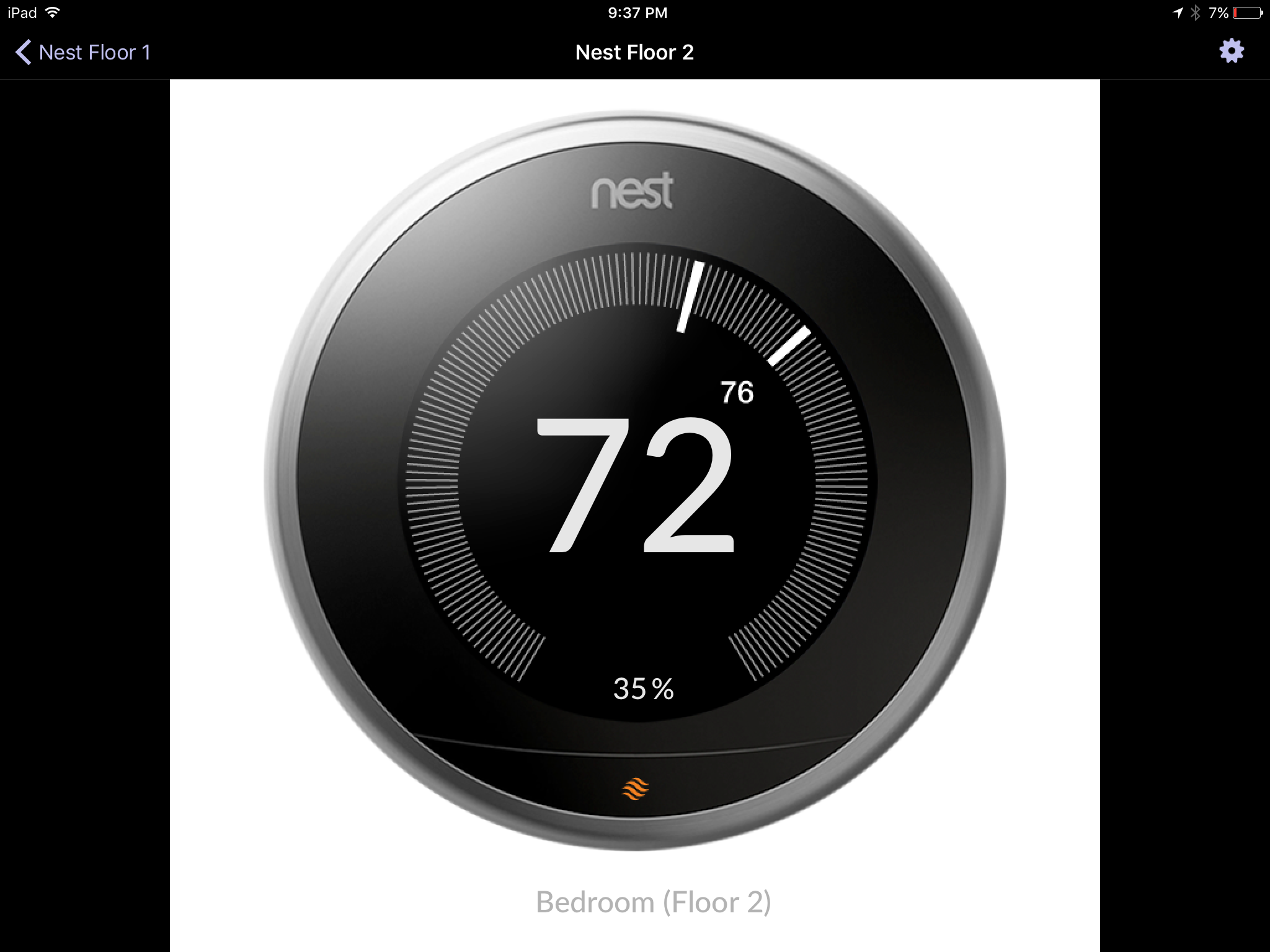

I recently hired a graphic artist at my company and have her creating indigo graphics for me in between work projects. I started with the nest and have most of the graphics done and working but I need some tweaks to the plugin to work around some of the unique ways the nest works. I am going to upload the graphics for everyone to use but I'd like to have it completely working first.
I am a seasoned sw developer but I don't know python and I don't think I have time to learn it right now.
Is anyone interested in picking up the nest home development or know who might be to help me make the changes to work with the graphics ?
Philip

Current graphics in both 300px and 600px diameter.
Layer 1 bezel in black and silver
Layer 2 center dial with scale in black off, orange heat, blue cool
Layer 3 ambient temp hash with numeric temp in 1 degree increments
Layer 4 current set temp hash
Current temp, humidity are text fields
I also have all the info icons like the heat cool mode (heat shown at bottom of dial)

- IMG_0378.PNG (425.52 KiB) Viewed 4902 times
Re: NEST Home is now on Github
Wow, that looks great!
