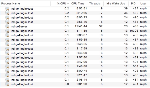

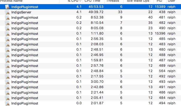

I'm seeing a very high CPU load with your plugin (v1.5.3). Indigo is running on its own server, a Macmini. I've created only 1 device with your plugin - "Convert Lux to Word value". The physical luminance device hadn't provided any updates for over a half hour so I don't think that there is a lot of updating going on for that device. I attached screen shots of Activity Monitor with your plugin enabled and disabled. All the other plugins are using 0.1 to 0.3 CPU%. Yours is averaging approximately 3.8% to 5%. Also, notice that Indigo Server CPU usage goes from 0.1% without your plugin to 4.1% with your plugin enabled.
I just discovered your plugin yesterday and really like it but I'm concerned about the CPU load. Is there something I'm maybe doing wrong? I just became an Indigo user in September.
- enabled.jpg (101.18 KiB) Viewed 4686 times
- disabled.jpg (102.59 KiB) Viewed 4686 times

4.1 doesn't seem exceptionally high to me considering that the plugin is monitoring another device 24/7. That particular plugin is a little out of date, I have a newer on that I need to push out that should be a bit less resource intense. I'm not sure if I can get it out there this week but I'll try.

Thanks for the reply. Not an expert by any means on plugins so I'm not in a position to discuss resource usage. It just seems like an outlier when it's using almost 20-40 times the CPU load compared to the 15 or so other plugins I'm using. Among others, I have Cynical SecuritySpy (4 cameras), Alexa-Hue Bridge and Virtual Energy Meter (17 devices) and they never go much over 0.2 or 0.3.Colorado4Wheeler wrote:4.1 doesn't seem exceptionally high to me considering that the plugin is monitoring another device 24/7. That particular plugin is a little out of date, I have a newer on that I need to push out that should be a bit less resource intense. I'm not sure if I can get it out there this week but I'll try.
It just jumped out at me when I looked at Activity Monitor. Still getting the feel for the whole Indigo ecosystem. I do appreciate all the plugin developers, like yourself, that provide these services for free. It's a great community. Thanks again.
