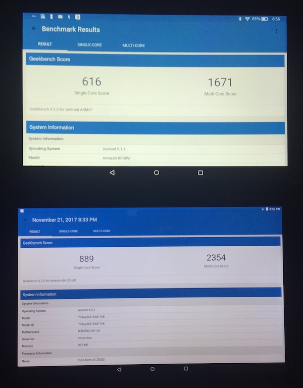

Yep, looks like it was just Vudo, Nook, and Walmart apps and they all uninstalled easily, at least on the 8" which is the one I'm playing with at the moment. Interestingly, Geekbench reports an Intel Atom processor and a paltry 895MB RAM. It's probably fine if it's just running DomoPad but I wouldn't load it down. The Fire 8 has 1.34 GB RAM but has a slower ARM proc. In the pic below, the Fire 8 (previous gen) is on top, the Walmart Nextbook Ares 8A on bottom .
