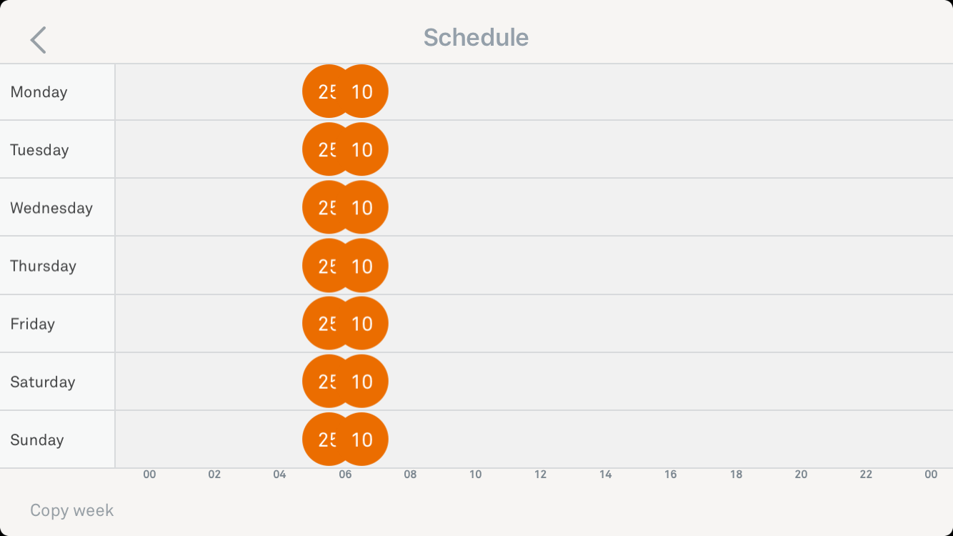

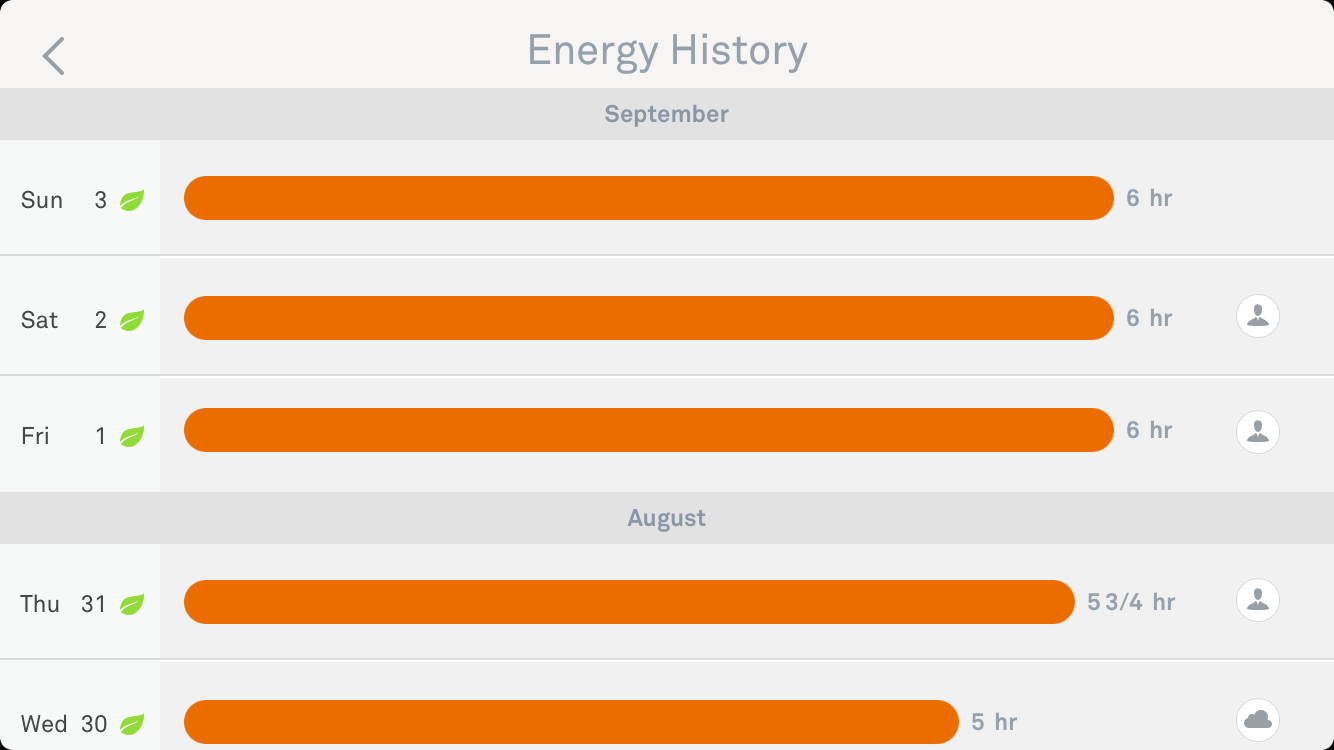

Hi Everyone,
I'm hoping that someone might be able to help with a Nest Plugin problem that i've been having. I've tried to get hold of Mike but think he must be off on his summer holidays!
Recently after upgrading to a Nest 3rd Gen, the plugin seams to be doing odd things. It will work fine for a couple of days, maybe even a week and then it will remove all the pictures and and control from my control pages and also any schedules that have been set within Indigo. I also get the following errors:-
I get this once a day!
2017-09-03 11:57:49.271 NEST Home Error versionCheck: There was an error parsing the server's version file.
This appears in the log every min.
2017-09-03 11:58:54.062 Error device "Hallway Thermostat" state key humidityInput1 not defined (ignoring update request)
2017-09-03 11:58:54.063 Error device "Hallway Thermostat" state key humidityInputsAll not defined (ignoring update request)
2017-09-03 11:58:54.064 Error device "Hallway Thermostat" state key humidityInput1 not defined (ignoring update request)
I've also found this morning that my central heating has been coming on for 6 hours overnight, triggered around midnight and going off at 6.30am. The off is triggered by a Nest schedule (not within indigo) set at 5.30am to 6.30am. I've set this schedule within the Nest App to turn on the heating in the morning and turn if off at 6.30am, but the on trigger is definitely coming from Indigo but i can't find anything in the event log. See the photos, these are the settings from the Nest App - something's bringing the heating on at midnight but can't work out what!
I've also posted this elsewhere but wasn't sure if anyone had seen it, so hoping this will be seen by the wider group.
Any ideas?
Thanks in advance,
Martin
