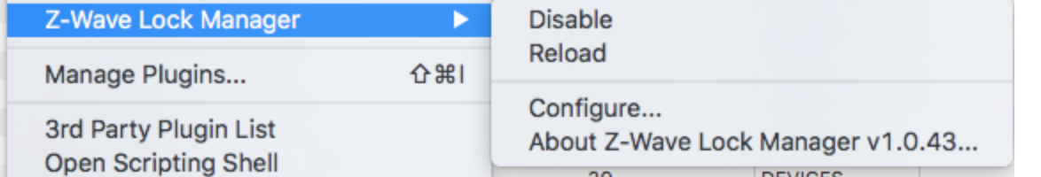

I get the Tag Reader not working, I followed Matt's instructions and installed a beta Z-Wave library, also using the latest version of the plugin 1.0.43
When I look at the plugin, I do not see the usual commands as for example Set User Pin.
Device details:

Benext Tag Reader 500 not working
- No commands visible

Hi Spike.
That screenshot is correct; there's no menu items missing there.
(There were some test menu items at one point, which I use for debugging - they shouldn't have been released publicly)
To set pins, create an action > Zwave manager actions > Set Pin.
I'll check through the Zwave commands you've posted once I've got my laptop out tonight.

Hi Peter,
Many thanks for your support, I got it working
Create an action did the trick.
Regards, Spike
Regards, Spike
