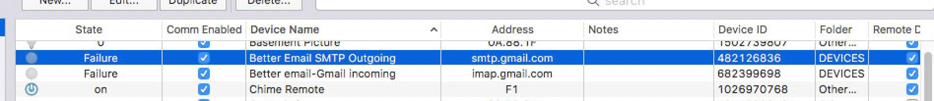

I am still getting that Better email status is Failure in the indigo main window.

ok error went away but why is the status still listed as Failure

Re: Failure of Better email
farberm wrote:ok error went away but why is the status still listed as Failure
Because I'm a terrible programmer. I don't update that field properly when using IDLE. I'll fix that in the next update. But if updating that field causes the error you were getting, that's going to be a problem. Hopefully Matt or Jay will have some clue what's actually causing the error.
