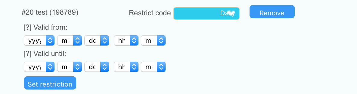

I have the Yale touch screen at two locations and am scheduling the "time Fence." It does work even when the home controller is dead or power is out.
Scheduling a reading weekly event requires a start date/time, end date/time and the day(s) that the fence is opened. Scheduling a continuous number of days only requires all days of the week to be selected and, of course, start date/time, end date/time.

- Schedule a block of days
- Setdaily.png (44.98 KiB) Viewed 9072 times
