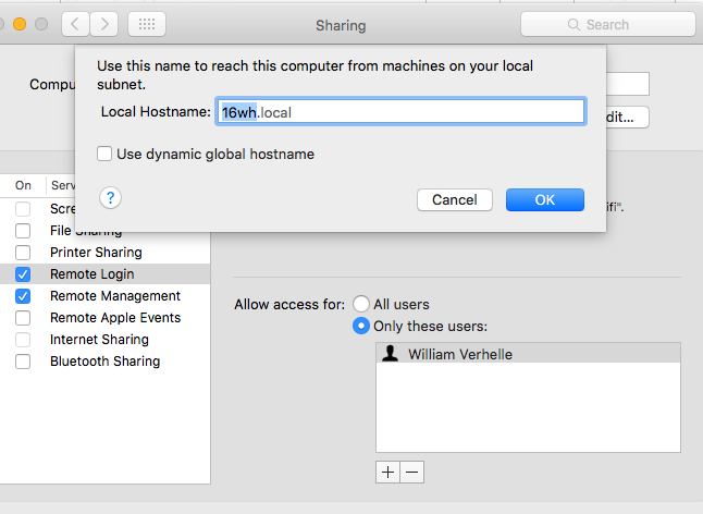

Use Dynamic Global Host Name is NOT selected. See: https://www.dropbox.com/s/n3c63pmkww1go ... 0.png?dl=0

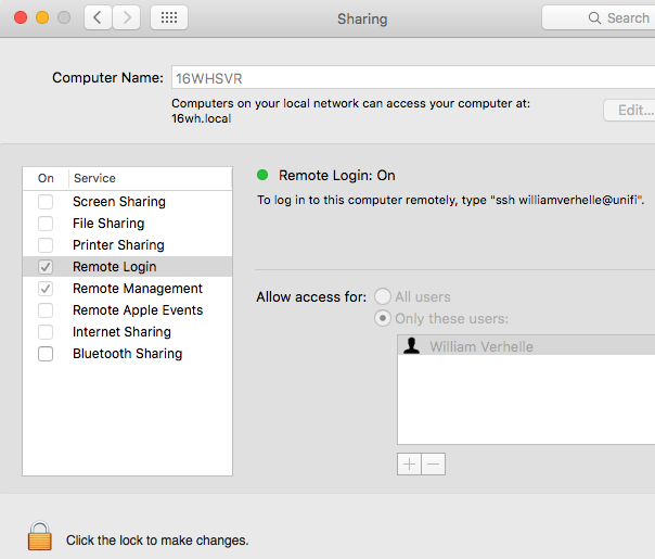

Computer Name Screen shot reflecting computer name:
See: https://www.dropbox.com/s/xire68pirbkwp ... 2.png?dl=0

Screen shot of dynamic global host name is NOT selected.
Screenshot 2016-08-05 15.05.10.png (58.87 KiB) Viewed 5881 times
Screen shot of computer name.
Screenshot 2016-08-05 14.52.22.png (63.49 KiB) Viewed 5881 times

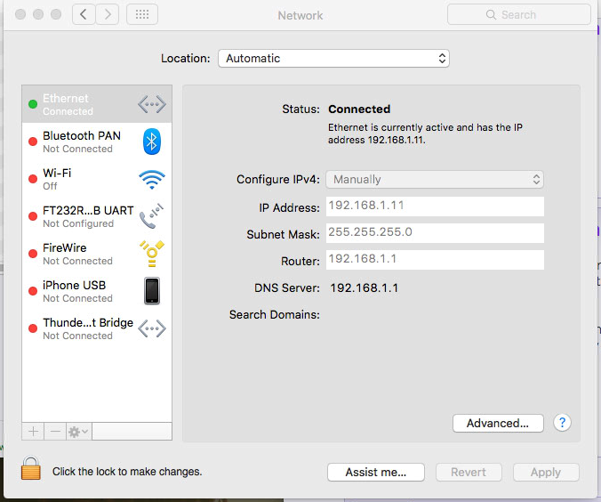

I have several extra network interfaces. See screen shot: https://www.dropbox.com/s/cz5taisdx9mjx ... 4.png?dl=0
Suggestions?
- Bill
Screen shot showing several extra interfaces installed on Mac Mini (formerly server)
Screenshot 2016-08-09 11.19.34.png (198.58 KiB) Viewed 5602 times
