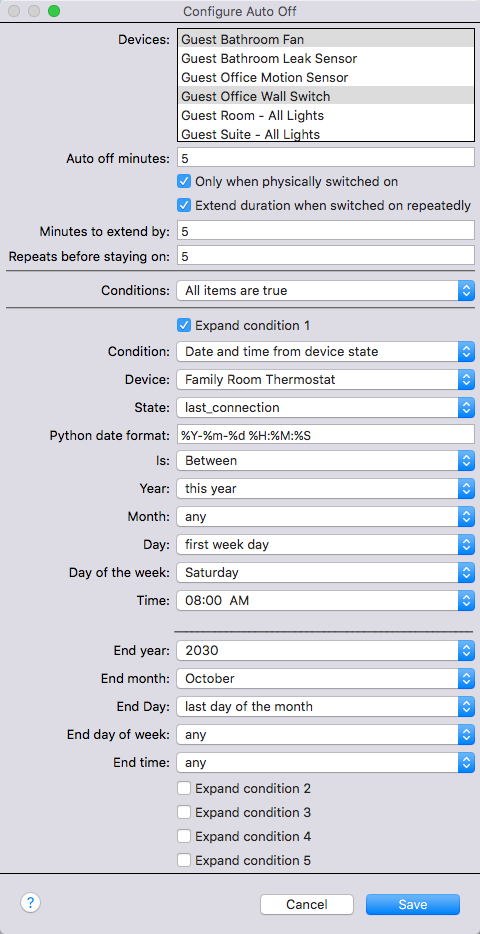

Configuration and Use
Screen Shot 2016-07-07 at 6.10.49 PM.png (127.17 KiB) Viewed 49150 times
  • Devices: One or more devices to include in this group. Each device is treated individually so when one times out it only impacts that one light, not the others in the group
  • Auto Off: Once a light is turned on this is how many minutes until it turns off automatically
  • Only When Physically Turned On: If this is selected then any "On" commands sent from Indigo will be ignored. This is so you can use automation to turn the light on as you need but if someone turns it on manually the timer kicks in
  • Extend Duration: You can optionally choose to extend the duration until auto-off by turning an already On device On again (or pressing the switch again)
  • Minutes to Extend By: If you want to extend the duration this is how much each On command extends the duration by. This is cumulative so if you put 3 minutes here and turn the device on three times then it will turn off in 9 minutes from the first turn on
  • Repeats Before Staying On: Lets face it, auto off can be an annoying feature, sometimes you want the light to just stay on, this lets you configure how many taps it takes to keep the light on.

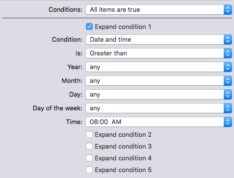

Conditions (New in 1.1)
Powermiser now supports extremely robust conditioning for when an auto-off should be used. For full documentation on conditions please refer to the Conditions Documentation Topic
Conditions - Date Time.png (45.1 KiB) Viewed 49151 times
