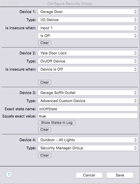

Each plugin device supports four devices, one of which can be another Security Manager plugin device. In this way you can monitor an unlimited number of devices to monitor as well as be able to break down your home security into zones (i.e., bedroom security, front door security, garage security, etc).
Add up to four devices per plugin device, you goal is to set this that if any of these devices are in the state you specify then it is NOT secure. If you have multiple Security Manager devices you can link them into any other Security Manager device and it knows that if that device is not secure then this group will fail security as well.

The options are fairly self explanatory, only one bears a bit more explanation - Advanced Custom Devices. If you want to really dial the plugin in then you can use any state of any device but you will need to know what the EXACT state name is as well as the EXACT value that determines it is insecure. The button "Show States In Log" will help you figure this out and will dump all of the states of the selected device to the log so you can see which one you want to use.
When it comes to naming, note that "onoffstate" is different than "onOffState" so make sure the state name is exactly as the log dump shows. For the value it's a little tricky since there can be so many different types of states (boolean, string, number, etc) so the current way to configure that is:
  • If the state is boolean then use either true or false as the value (WITHOUT quotes), the plugin will properly interpret that as boolean. You can use any variation of the word true or false (True, true, TRUE, TrUe, etc)
  • If the state is a string the surround the value with double quotes, i.e., if state UIDeviceState is "on"
  • A non quoted value is literal and should generally be a number

  • Example: When the garage door I/O linc is off (door is open) and the door lock is off (unlocked) then we are insecure, therefore the device shows a state of Off

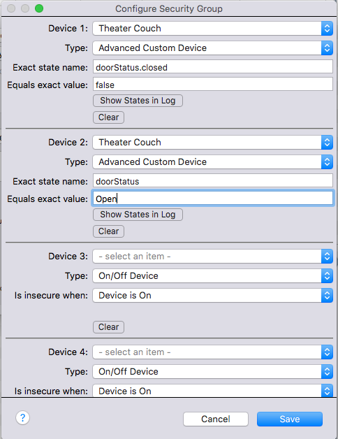

I have some devices that I'd like to add to a security group where I need to test for a specific enumerated state to be true or false. I tried to set it up for a custom device to be a value of "false", but I don't think it's working. Here's the state dump for the device:
     doorStatus : Open (string)
     doorStatus.closed : false (bool)
     doorStatus.closing : false (bool)
     doorStatus.open : false (bool)
     doorStatus.opening : false (bool)
     doorStatus.stopped : false (bool)
Can I do a test for doorStatus.closed = False?

Neither of these two things work? I need to update this plugin a little bit as I've done a lot of specialty coding for states that I want to incorporate into this one as well, but theoretically one of these two statements should work:
