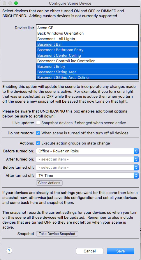

Configuration and Use
Select all of the devices to be included in the scene (command-click to select multiple items). You can save it like this and it will work or utilize the other options:
  • Live Update: If selected you can use this instead of taking a snapshot of the scene, so you select your devices and save the configuration. Once saved, you then turn On the Scene Device itself. From here simply set the lights in the scene to whatever level you want them, when you turn the Scen Device off again those settings will be stored
  • Do Not Restore: The plugin will store the current states of all devices in the scene before it changes them all to match your snapshot, once your device is turned off all of the devices will return to their previous state. By enabling this option you are telling the plugin to ignore the previous state and always return the devices in the scene to an Off state
  • Actions: If you want to incorporate action groups into your scene you can choose to execute those groups for the four stages of this plugins use: before turning on, after turning on, before turning off and after turning off
  • Clear Actions: There is no simple method to select "none" in the action list popups, this will clear ALL actions. This is useful if you decide you no longer want to execute something, say, after the scene is turned off - however you will need to re-select the other actions you may want to still execute
  • Take Snapshot: This will only show up if you do NOT have Live Update selected. Clicking this button will store the CURRENT states of all devices in the scene so it knows what to turn on/off or dim/brighten when you turn the scene on
Screen Shot 2016-05-19 at 1.18.28 PM.png (484.11 KiB) Viewed 11278 times
